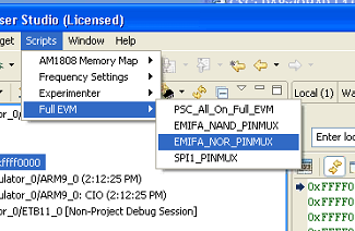

    I have an issue using the AM1808 EVM kit trying to flash to the NOR flash on the UI board.
    I have followed the instructions on the following links:
    http://processors.wiki.ti.com/index.php/GSG:_Building_Software_Components_for_OMAP-L1/AM1x
    http://processors.wiki.ti.com/index.php/GSG:_DA8x/OMAP-L1/AM1x_DVEVM_Additional_Procedures#Flashing_images_to_NOR_Flash
    I have created the norflash-writer and ubl-omapl1x8 and build each and then generate the AIS file.
    On the CCS4 I can see the script menu but it is not accessible for set the Full EVM-->EMIFA_NOR_PINMUX.
    Also I don't know how to run norflash-writer.
    "Run the NOR flasher program. You will be prompted for the input file type and the file path. For booting from NOR, an ARM AIS image and U-Boot are required"
    Please advise
    Ofer
  • Ofer,
    I just checked and found that there is a new version of the AM1808 GEL file at the LogicPD support page. As you can see in the screenshot at the end of this post, it contains the GEL menu option mentioned in the page you sent. The debugger must be active and the device must be connected for the GEL functions work.
    To run the NOR flasher you must launch the debugger, connect to the device, load the norflash-writer you created and then run - all within CCSv4. The norflash-writer will probably prompt to point to the ARM AIS and the U-boot files. For details, follow steps 1 thru 4 of the page below:
    http://processors.wiki.ti.com/index.php/GSG:Connecting_to_slave_cores_in_SoC_devices
    Unfortunately I don't have a board with me (I captured this image from a remote machine) and therefore do not have all the exact screenshots with me, but this is the typical procedure for these devices.
    Hope this helps,
    Rafael
