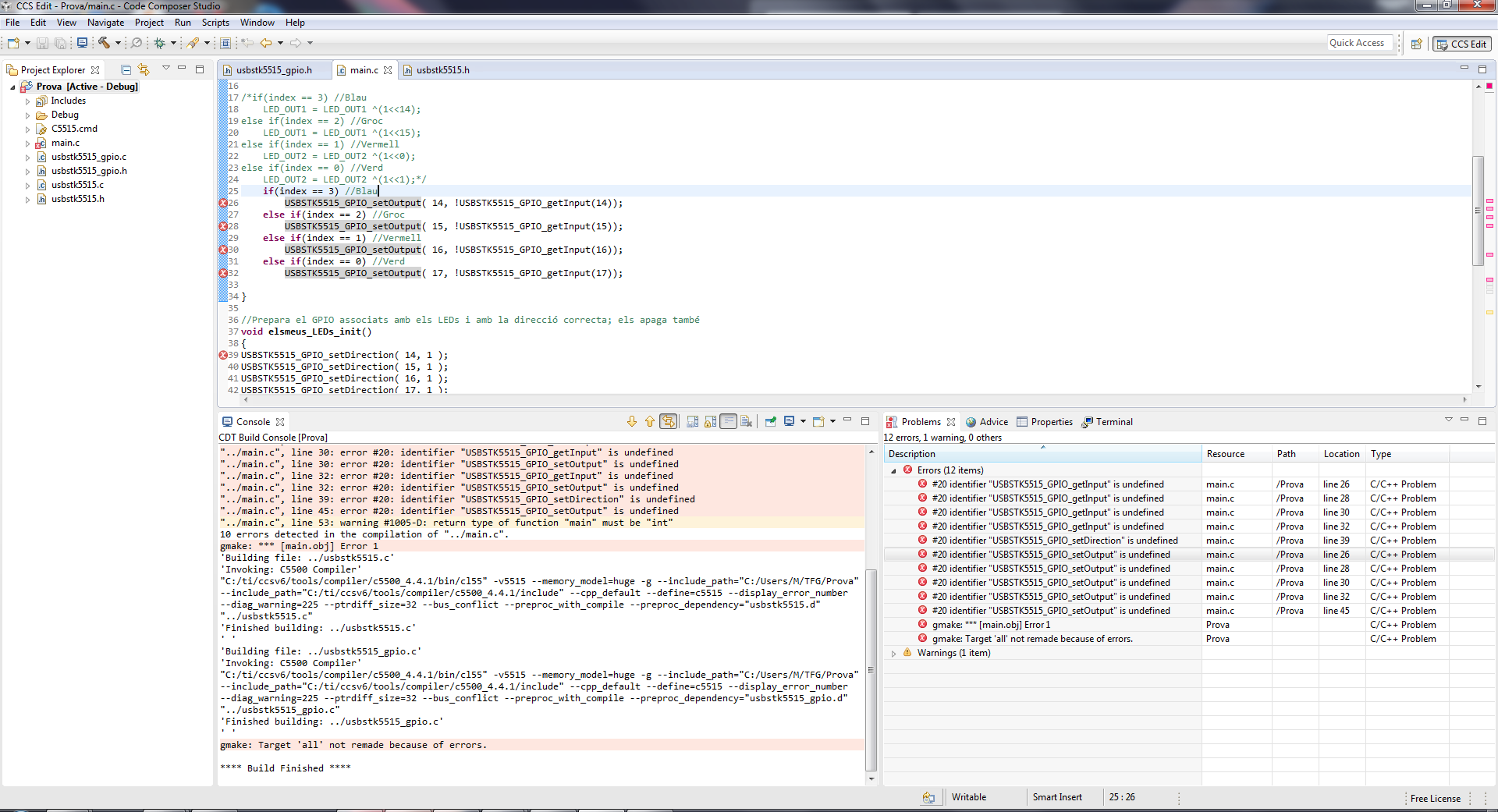

  • Ok, to understand all of these configuration, now I'm trying to compile a basic project which is this one (bassicaly turn on/off leds):
    And I still get similar errors.
    The "USBSTK5515_GPIO_setOutput" funciton is declared at "ubstk5515_gpio.h" and "ubstk5515_gpio.c" files, which they are in the same file as main.c,
    The compiler should 'see' the declaration but it seems it can't locate it.

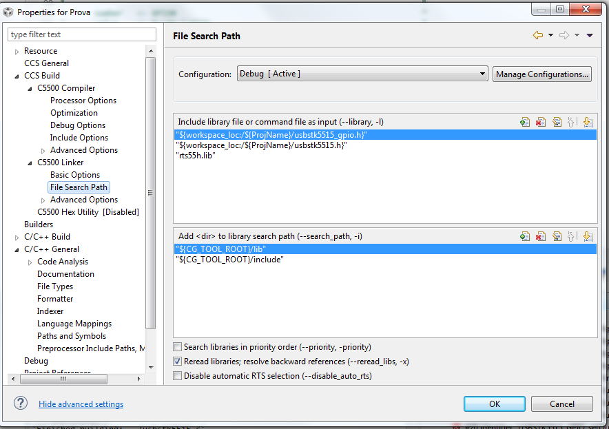

    And I have this in File Search Path
    Am I referencing the headers right?
    Why compiler can't locate the function? What is it that I'm missing?
    thanks a lot.
    No. Header files are not specified under --library option (this option is only for library .lib files). The path to header files (just the path, not the name of header file) should be specified instead under C5500 Compiler->Include Options->--include_path. The header file should be #included in the C source wherever required.
