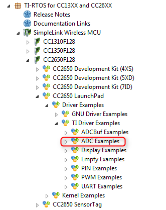

Hi
I am trying to create a ADC reading functionality using cc2650. I have created a new project by following the ccsv6 guide and copied necessary files and build the projects.
Initially I have an error as "unresolved symbol RestISR" . It was removed by following a solution that posted in the TI forum.
Link to the solution   -> https://e2e.ti.com/support/development_tools/code_composer_studio/f/81/t/430252
I added the startup_ccs.c and driverlib.lib as in the above solution.
But currently I am getting a bunch of unresolved symbol errors as follows.
undefined                                                                                                        first referenced
symbol                                                                                                             in file
ti_sysbios_family_arm_cc26xx_Power_setDependency__E              ./Drivers/PIN/PINCC26XX.obj
ti_sysbios_family_arm_m3_Hwi_Params__init__S                              ./Drivers/PIN/PINCC26XX.obj
ti_sysbios_family_arm_m3_Hwi_construct                                             ./Drivers/PIN/PINCC26XX.obj
ti_sysbios_family_arm_m3_Hwi_disableFxn__E                                  ./Drivers/PIN/PINCC26XX.obj
ti_sysbios_family_arm_m3_Hwi_restoreFxn__E                                   ./Drivers/PIN/PINCC26XX.obj
ti_sysbios_knl_Semaphore_Params__init__S                                      ./Drivers/PIN/PINCC26XX.obj
ti_sysbios_knl_Semaphore_construct                                                     ./Drivers/PIN/PINCC26XX.obj
ti_sysbios_knl_Semaphore_pend__E                                                     ./Drivers/PIN/PINCC26XX.obj
ti_sysbios_knl_Semaphore_post__E                                                      ./Drivers/PIN/PINCC26XX.obj
All these symbol are of data types related to XDC tools.
Currently my newly created project does not have any section to configure XDCtools under Build settings. How can I incorporate XDC configurations to my newly created Project?
