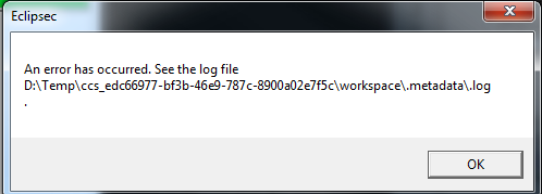

I am having a difficult time installing CCS v6.1.3.00033 from the offline installer.  I am receiving the following error dialog box:  An error has occurred.  See the log file at ...\AppData\Local\Temp\ccs_b7003f4a-6b5e-47b6-457b-749886703776\workspace\.metadata\.log (appended below)
I a using Windows 7 64-bit, SP1
McAfee was disabled and I have previously and successfully installed CCS v5.5
Thank you,
Eric

  • Hi Eric,
    Could you please zip up and post the contents of all c:\ti\ccsv6\install_logs* folders?
    Danish
  • Could you tell me what the output of this command is when run from a command window?
    WMIC QFE|find "KB2999226"
    If it doesn't find anything, could you install this: https://www.microsoft.com/en-us/download/details.aspx?id=49077
  • WMIC QFE|find "KB2999226" does not return anything.
    I attempted to install the Windows 7 update indicated, but I am getting a dialog indicating that the update is not applicable to my computer
    KB2999226-install-denied.docx
  • I compared the log files to my installation and observed two things in the
    Ccs_setup_6.1.3.00033_intall.log
    1) It can't find bin/fs
    07/27/2016 21:19:42(GMT) - runFSClean - CCS_WARNING: Couldn't run c:/ti/ccsv6/ccs_base/common/bin/fs --clean
    2) There are no com.sd installs
    Configuring com.sd.ccstudio.emulation.win32.feature.group
    Configuring com.sd.ccstudio.emulation.win32.feature.jar
    Configuring com.sd.ccstudio.emulation.win32_root
    Unfortunately I've no idea how to get them. UPDATE: These are the spectrum digital (sd) tools. To get them, one needs to select the Spectrum Digital tools option at installation.
    Cheers2u
    Eddie

    Could it be that he does not have the latest Java installed? I noticed that his dos output from "set" command does not have the environment variable below.
    JAVA_HOME=C:\Program Files\Java\jre7\bin
  • Sorry, the link I provided was for the 32-bit KB package. Please install this one instead: www.microsoft.com/.../confirmation.aspx (The 64-bit version.)
    My suspicion is that you do not have the OS patch required to support the Visual Studio Universal Runtime. Another way to get the patch would be to make sure your OS is completely updated through Windows Updates.
  • Hi
    Mine is a system that works with CCS. The output of the command is below
    U:\>WMIC QFE|find "KB2999226"
    support.microsoft.com/ EPATTOPC Update KB2999226 XXXXXXXX\epatto 12/9/2015
  • That patch was the missing piece. Thank you.
