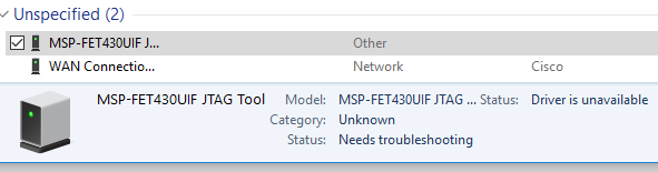

  • My Control Panel view looks a bit different, but shows the FET device as present but without a driver:
    I tried the "troubleshoot" tab, which spun for a while and had me "restart" the PC, but still the same result.
    Wouldn't the Driver come along with the CCS (version 6.1.3)  install?

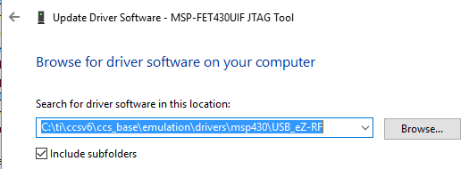

    CCSv6.1.3 should have installed this automatically and the device drivers for this board is actually hosted in the CCS install directory. You can manually point to the following path:
    C:\ti\ccsv6\ccs_base\emulation\drivers\msp430\USB_eZ-RF
    Unfortunately the variability of Windows OS makes it very difficult to pinpoint an exact cause to what may have happened in your case, but please give the manual install a try.

    been out for a couple days so just tried your post now.  Win 10 still fails;    I get to the following screen and locate the folder you mention

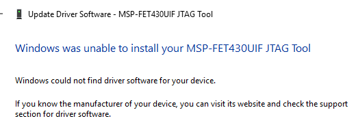

    I then click "Next" with the following result:

  • My Dell laptop has 2 USB2.0 port and 1 USB3.0.  My ez430 has been using the 2.0's.
    although Windows 10 Device Manager continues to recognize that the ez430 is present, I have not been able to get it to accept a driver for it from the suggested location.
    Likewise for an MSP-FET430UIF that's several years old (and may have never been used yet).  CCSv6 User's guide points to
    c:\ti\ccsv6\ccs_base\emulation\drivers\msp430\USB_CDC for its driver, but also fails to install for that device.

    To be honest, I am starting to suspect two things:
    - Your ez430 is failing. Easy to test if you can use different PCs to test it;
    - Your Windows 10 system somehow had device drivers installed from a previous version; the procedure to completely remove the lingering device drivers is shown in the reference below:
    http://processors.wiki.ti.com/index.php/Troubleshooting_CCSv6#Clearing_out_an_existing_installation
