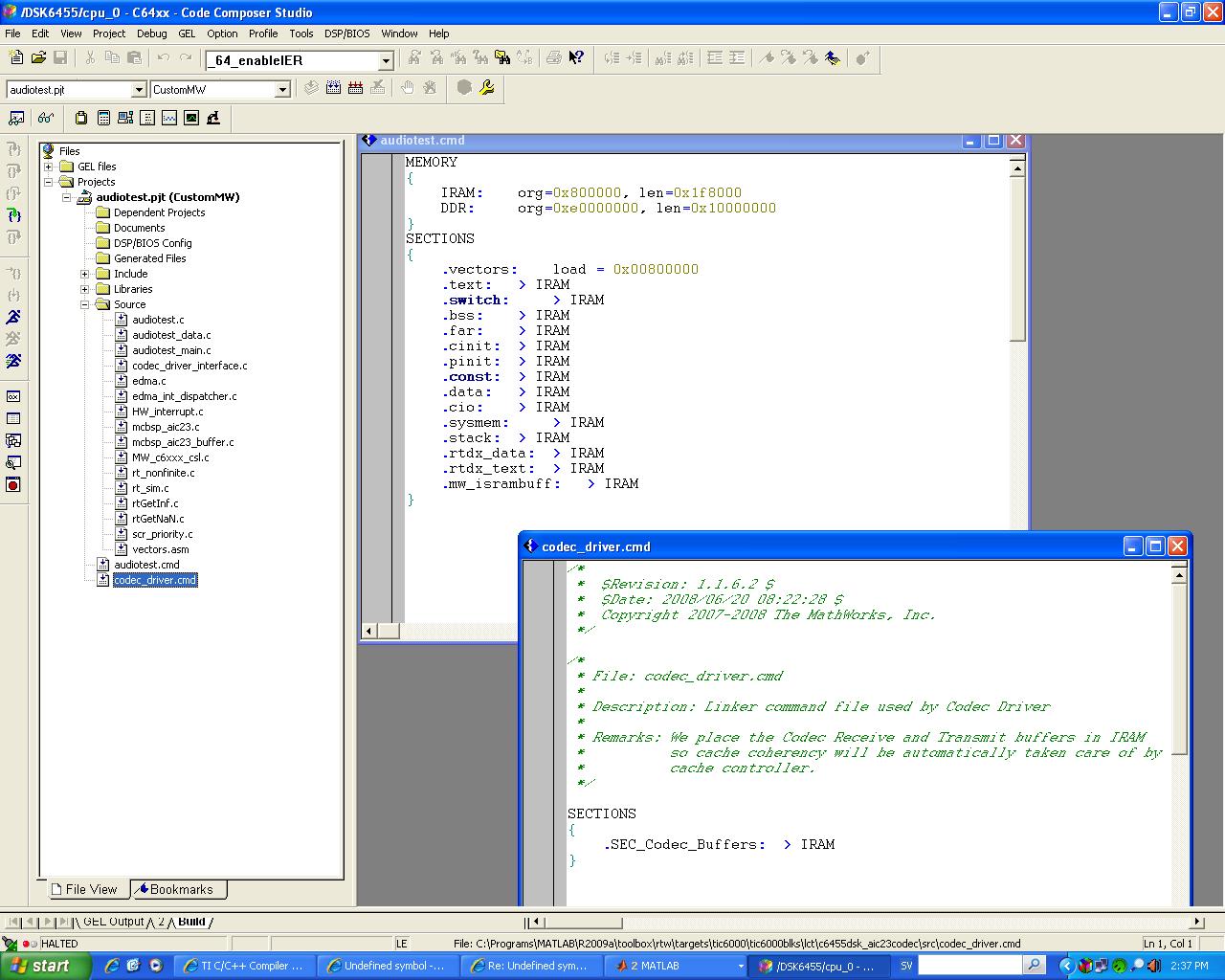

I have seen some problems similar to mine in this support platform but still nothing solves my compilation failure...
Could you recognize a special error in my code thanks to that response? Which procedure do I have to undertake ?
Many thanks in advance
Please find the error message below :
[Linking...] "C:\Programs\CCStudio_v3.3\C6000\cgtools\bin\cl6x" -@"CustomMW.lkf"
<Linking>
undefined                        first referenced
 symbol                              in file
_C64_enableIER                   C:\\Documents and Settings\\maxime\\Desktop\\project\\PERON\\Simulink\\audiotest_ccslink\\CustomMW\\codec_driver_interface.obj
_SEM_pend                        C:\\Documents and Settings\\maxime\\Desktop\\project\\PERON\\Simulink\\audiotest_ccslink\\CustomMW\\codec_driver_interface.obj
_C64_disableIER                  C:\\Documents and Settings\\maxime\\Desktop\\project\\PERON\\Simulink\\audiotest_ccslink\\CustomMW\\codec_driver_interface.obj
_SEM_post                        C:\\Documents and Settings\\maxime\\Desktop\\project\\PERON\\Simulink\\audiotest_ccslink\\CustomMW\\edma.obj
_HWI_dispatchPlug                C:\\Documents and Settings\\maxime\\Desktop\\project\\PERON\\Simulink\\audiotest_ccslink\\CustomMW\\HW_interrupt.obj
_HWI_eventMap                    C:\\Documents and Settings\\maxime\\Desktop\\project\\PERON\\Simulink\\audiotest_ccslink\\CustomMW\\HW_interrupt.obj
__SEM_dopost                     C:\\Documents and Settings\\maxime\\Desktop\\project\\PERON\\Simulink\\audiotest_ccslink\\CustomMW\\mcbsp_aic23_buffer.obj
>>   error: symbol referencing errors - 'audiotest.out' not built
>> Compilation failure
Build Complete,
  2 Errors, 0 Warnings, 0 Remarks.

  • Hi Maxime,
    These are linker errors indicating that your compiler cannot find references to the above declared functions in the memory map. This may happen due to faulty linker (.cmd) file or faulty spellings of functions in code. Can you post the code and linker file here?

  • Hi
    The project is done directly by simulink so I have a lot of ( Include , Libraries, Sources, and two commands)
    I can write the two commands which are the linkers if I understand, and then the main program : ( I am sorry for the length of the message)
    Thank you very much

  • Hi Maxime,
    This seems to be incomplete, for eg, the linker error says that there exists an unreferenced variable in HW_interrupt.obj, which sould be the name of a function or a source file. But it doesnt exist in the code.
    Are you sure you have the entire code, is it using some other path or other options for linking? If yes ,try to modify Linker options in Build Properties.
    Sid
  • Hi Maxime,
    The functions missing are DSP/BIOS functions, and looking at your linker command file it does not look like you are using DSP/BIOS, can you check for me?
    When you use DSP/BIOS you have a tcf file in your project and this TCF file generates a cmd file that needs to be included in the file.
  • Hi
    Exactly i don't have any DSP/BIOS Config in the project !
    This project is done thanks to Simulink. What should I do to make this DSP/BIOS function ? (act on Simulink or CCS?)
    (I dont know if it is important to know that I have installed DSP/BIOS 5.33.06 and selected in CCS component manager...)
    Thank you

  • Hi
    It is working properly now.
    Problems were in Simulink > Configuration Parameters. In Real Time Workshop the DSP/BIOS was not taken into account...
    Now compilation and implementation are working well.
    Thank you all very much for your help
