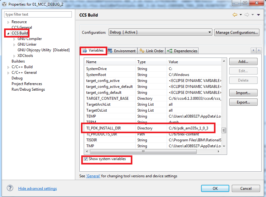

The variable TI_PDK_INSTALL_DIR is not defined either under Linked Resources or Build Variables.  However, when attempting to add the linked file as above, this variable appears.  It also appears when adding additional INCLUDE PATHS to the project (GNU compiler), where I can click the "+" button to ADD an include directory, click the "Variables..." button and the variable TI_PDK_INSTALL_DIR is listed, with the defined value of:
        C:/ti/pdk_am335x_1_0_3
which is correct.
It is probably pertinent that when I attempt to modify the LINK PROPERTIES to use the relative path
        ${TI_PDK_INSTALL_DIR}\packages\ti\drv\uart\soc\am335x\UART_soc.c
it complains with a message near the top of the dialog box under the "Edit a Link Location" title:
        "Path does not exist."
