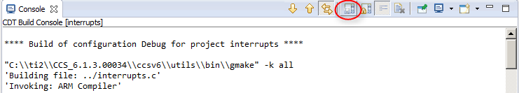

  • Can you go to the CCS Edit perspective (click on it at the top right part of CCS workbench), then keep the console view open and rebuild your project?
    The build output should appear in the console and you should be able to copy it off to a text file using the "Copy Build Log" icon shown below.
