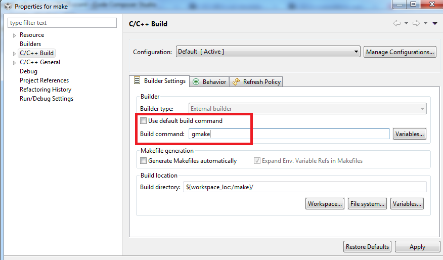

    CCS ships with gmake, not make. Try changing the build command in the project properties to use gmake

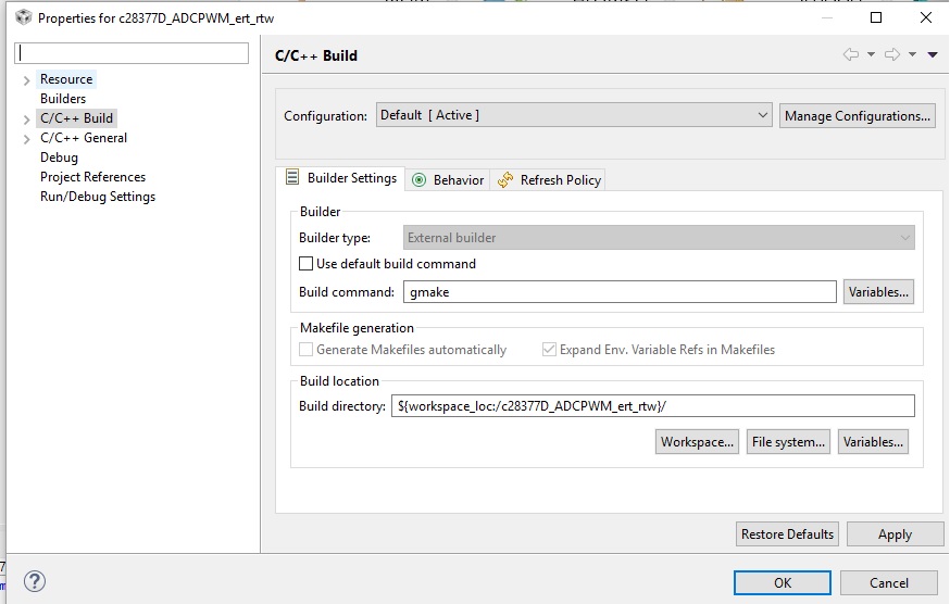

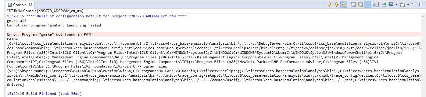

  • Hello Ki,
    thanks for your answer. I tried with your suggestion, but still I have a build error:

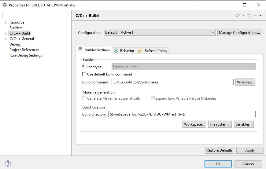

  • If the path to gmake is not in your system path, you can specify the full path to it. gmake is installed in <CCS6 INSTALL DIR>\ccsv6\utils\bin
  • Hello Ki, thanks for your answer.
    I have tried with your suggestion, but still does not build the project. I attach relevant screenshots below:
