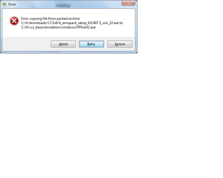

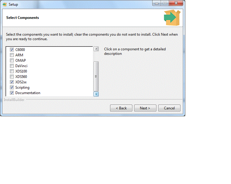

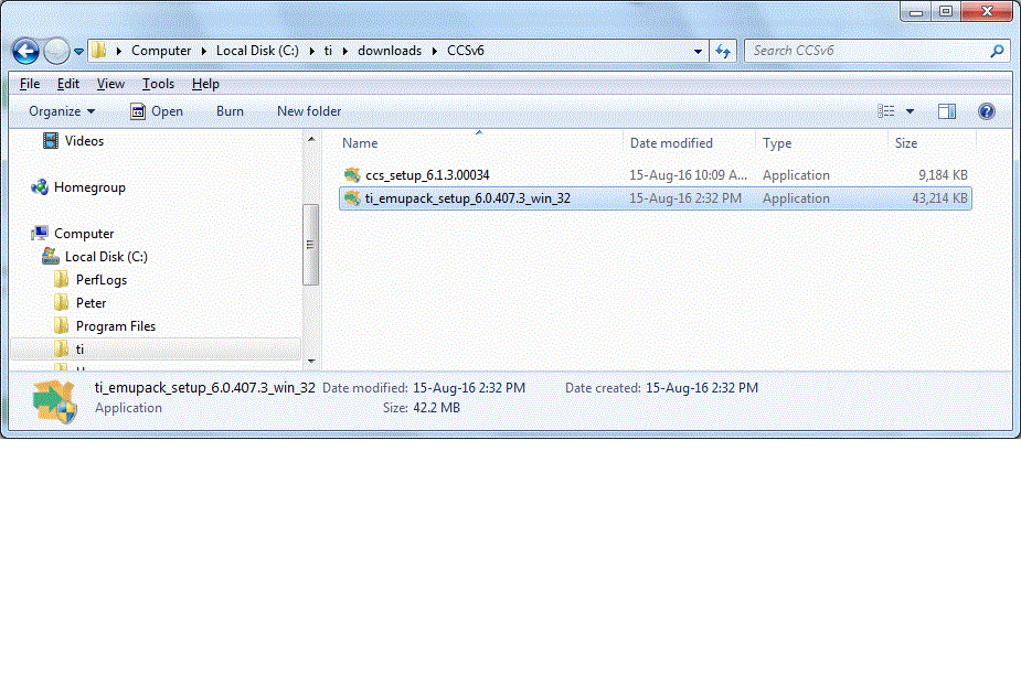

    See the three screen shots to see what happened when I tried to install the new emulation.

  • Hi Peter,
    It looks like you're trying to install the emulation package by double clicking on it, is this correct? It's not meant to be installed separately like that, you could be missing parameters to the install. Could you please zip up the contents of any install_logs* folders in the ccsv6 folder and post them here? I'll tell you what the correct parameters are.
    Danish
  • Thanks for the advice. Here are (I hope) the two install logs. I had to install a new version of Winzip, so I'm not quite sure what its done.
    Peter
    Something seems to be preventing the installer from writing a file. I'm unable to tell what that is. Could you please reboot the machine before doing the following:
