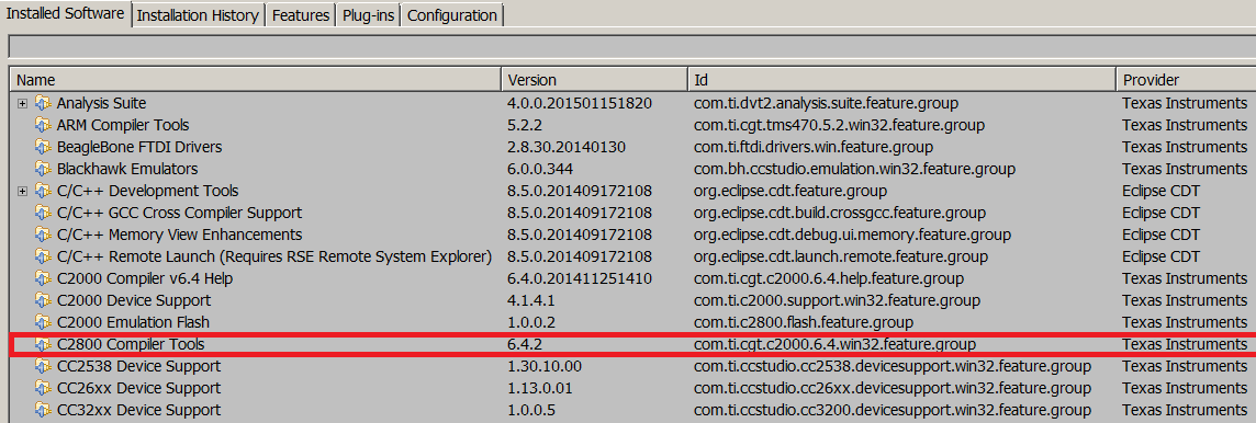

    What ISA are you using? What version of the compiler? (The compiler version is different than the CCS version)

  • Thank you for your reply. here us the compiler information.
