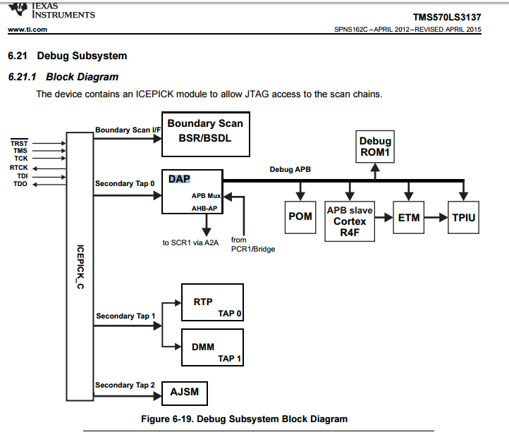

  • Furkan Aydogan1 said:
    I have a TMDX570LS31CNCD board (which has Cortex R4 core like Hercules Launchpad) and i can access registers when target is running. If cortex devices does not support real-time register access, how it could be possible with that board ?
    When I asked a similar question in Can't get CCS 6.1 "Continuous Refresh" for Memory or Expression views to work for Hercules devices got a response that not all Hercules devices have the functional path wired to allow access to the memory map via DAP to support real-time access.
    The datasheet for the TMS570LS3137 shows more functional paths connected to the DAP:

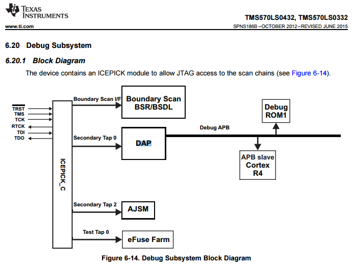

    Than for the TMS570LS0432 device:
    I am not sure if that is the reason why the TMS570LS0432 can't access registers while the program is running.

    Thanks for point out debug subsystems. I have examined ETM and TPIU modules which LS04 series does not have. As far as i understand this modules used for real-time trace. I am still not sure if DAP is enough for real-time trace or ETM and TPIU modules are required.
