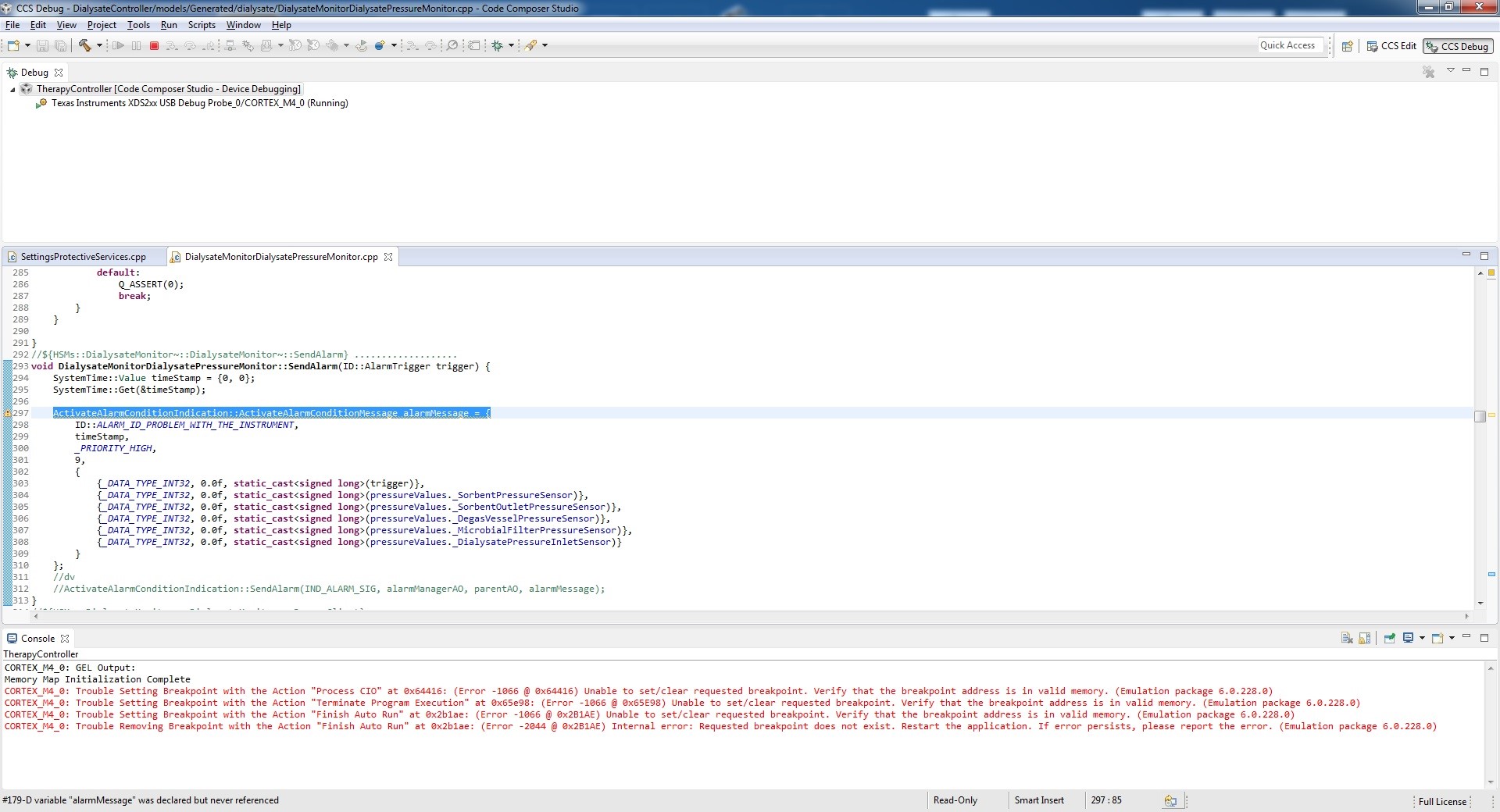

My CCS solution contains 4 different projects for 4 instances of our multiprocessor product which contains 4 TM4C129X Tiva processors.
I have all 4 projects configured similar. I have noticed I can compile/download and debug only one project in the solution with our xds200 emulator probe.
When I download the working project it erases flash, downloads the program and breaks at main. I can single step etc. all is ok. But if I try another project it erases flash, downloads program but will not break at main. I get 4 red error messages in the Console saying "CORTEX_M4_0: Trouble Setting Breakpoint with Action xxx.
The program does download correctly as a subsequent reset verifies the program was flashed correctly.
I have reset all "Debug" parameters to default and as far as I can tell all 4 projects are configured exactly the same. I have cleared all breakpoints but still no luck.
The 4 hardware boards are very similar to the Launchpad set up so I assume its not hardware. I did not have this problem way back when we initially started this project but that was many CCS versions earlier.

  • I have not modified the gel files. I assume they are all the same as it downloads and flashes all four projects correctly. Its just on three of the projects I can not break. from console output it looks like CCS is complaining about invalid memory address.
  • tried setting the scripting console as you suggested and I get:
    js:> eval("DEBUG_DumpBreakpoints()")
    Unable to perform operation, no active debug session.
    (C:\ti\ccsv6\eclipse\configuration\org.eclipse.osgi\602\0\.cp\resources\debugserver\assert.js#7)
    I tried running the
    eval("DEBUG_DumpBreakpoints()") both before and after the launching the debug session ...same result.
    same error messages:
    CORTEX_M4_0: GEL Output:
    Memory Map Initialization Complete
    CORTEX_M4_0: Trouble Setting Breakpoint with the Action "Process CIO" at 0x8afb6: (Error -1066 @ 0x8AFB6) Unable to set/clear requested breakpoint. Verify that the breakpoint address is in valid memory. (Emulation package 6.0.228.0)
    CORTEX_M4_0: Trouble Setting Breakpoint with the Action "Terminate Program Execution" at 0x8c684: (Error -1066 @ 0x8C684) Unable to set/clear requested breakpoint. Verify that the breakpoint address is in valid memory. (Emulation package 6.0.228.0)
    CORTEX_M4_0: Trouble Setting Breakpoint with the Action "Finish Auto Run" at 0x219f6: (Error -1066 @ 0x219F6) Unable to set/clear requested breakpoint. Verify that the breakpoint address is in valid memory. (Emulation package 6.0.228.0)
    CORTEX_M4_0: Trouble Removing Breakpoint with the Action "Finish Auto Run" at 0x219f6: (Error -2044 @ 0x219F6) Internal error: Requested breakpoint does not exist. Restart the application. If error persists, please report the error. (Emulation package 6.0.228.0)
  • Its almost like the memory map get corrupted AFTER the flash is erased and the program is downloaded but before breakpoints are set.
