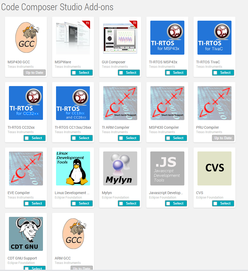

On my machine running Windoze 8.1 I recently had to do a clean install to update CCS to version 6.1.3 from 6.1.1.  Since then the App Center seems to have forgotten most of the add-ons which have been installed.  The only ones that show as up to date are MSP430 GCC, PRU Compiler, and ARM GCC.  Every other add-on previously installled shows only the "Select" checkbox.

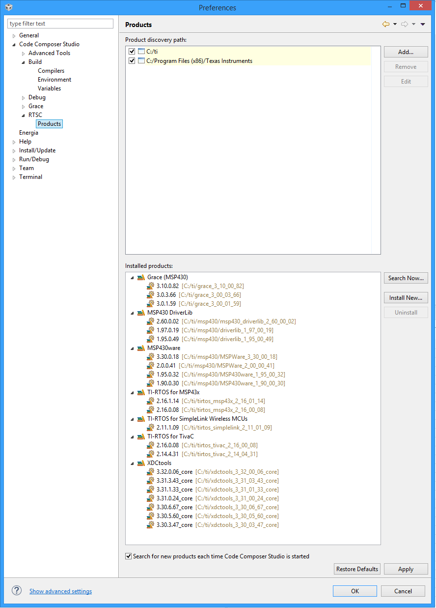

    Add-ons from the App Center get installed to the root folder that is selected for the CCS installation, and that is where CCS will look for the add-on, check its version, and if a newer version is available show it in App Center. If you install another version of CCS to a different folder, then the add-ons installed to the previous directory will not be "known" to the new CCS, so App Center will give you the option to re-install them. You don't have to necessarily re-install them though if you already have an installation in a different folder. You can simply provide the Product Discovery path to CCS (from Window->Preferences->Code Composer Studio->Build->Compilers or Window->Preferences->Code Composer Studio->RTSC->Products).

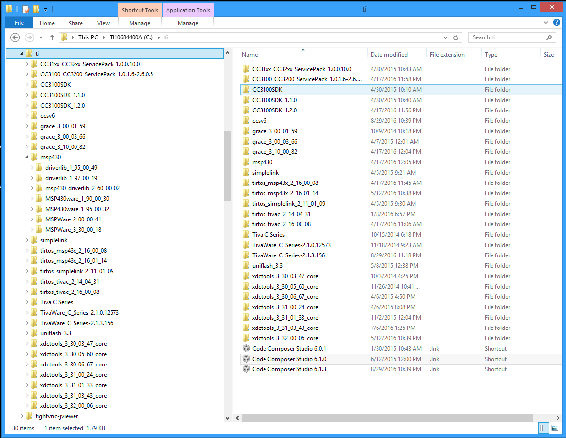

  • My memory is a little foggy regarding the exact steps I took.  The normal process of updating CCS failed miserably several times so I decided to download the installer and run it.  It seems logical that I would have uninstalled the older version first based on past experience; if so, I would have done so through Control Panel. FWIW, the 'C:\ti' directory still has '.lnk' files for versions 6.0.1 and 6.1.0 but they all point to the same executable.  I installed 6.1.3 in the default location 'C:\ti\ccsv6'.
  • The App Center always has the latest version of a software package. Based on your screenshots I can confirm that for all the add-ons that show the "Select" checkbox, there are newer versions of that package available than what is in your installation, which is why it is giving you the option to Select and install the latest available version. You don't have to install them (if you don't have a need for the latest version) and can continue to use the versions you already have, but that is the reason the App Center is displaying them that way.

    Actually it does already do that. In my install where I have some of the add-ons already installed, for those where an updated version is available it shows "Update" instead of "Select".
  • It always did. Ever since the last update, as you can see, my install seems to have gone dumb.
