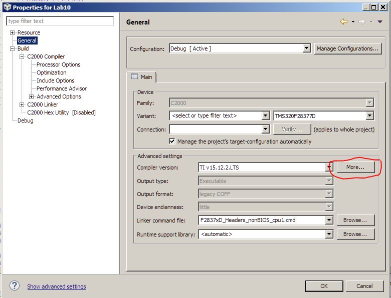

  • This does appear to be a Windows-specific problem in 15.12.2.LTS. The good news is that the problem doesn't seem to occur in 15.12.3.LTS. This will require some investigation.
  • Now tracking as CODEGEN-1538
  • d,
    Which compiler version are you using?
    Update your compiler to v15.12.3.LTS or later.  I don't see it showing up under Help->Check for Updates, but you can get it here:
    http://software-dl.ti.com/codegen/non-esd/downloads/download.htm
    I checked compilation, and the problem goes away with 15.12.3.LTS.  I also checked the latest compiler 16.6.0.STS and no problem there either.  The compiler team will analyze the issue to make sure we understand what is going on.
    After you run the compiler installer, that compiler version will still not appear in the CCS project properties compiler version pulldown list.  You need to click "More" and then "Select new compiler from file system."  Then browse to where you installed the new compiler.  After doing this once, the version will appear in the pulldown list.
    David
  • I was using the TI compiler v15.12.1.LTS, which is what came with CCS 6.1.3.00034.  Moving to v15.12.3.LTS has indeed fixed the issue.  Thanks!
