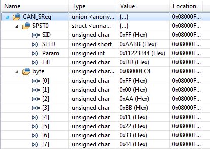

I'm working on a program in CC6.1 and have come across a strange problem that I cannot resolve.
I have a definition of a structure as shown below:
typedef union {
struct {
uint8_t SID;
uint16_t SLFD;
uint32_t Param;
uint8_t Fill;
uint8_t byte[1+7];
}TYPE_CAN_SREQ;
Then I fill and call the structure as shown below again:
CAN_SReq.SID = 0xFF;
CAN_SReq.SLFD= 0xAABB;
CAN_SReq.Param = 0x11223344;
CAN_SReq.Fill = 0xDD;
wait(1000);
canTransmit(canREG1, canMESSAGE_BOX8, CAN_SReq.byte);
The problem comes when I actually look at the results in CAN_SReq.byte.  The output of this is shown in the image below.  There is extra data in byte[1] that shouldn't be there.  It's not data from any of the existing variables, so I don't know where it's coming from or how it's getting there.  Any help would be much appreciated.

  • It might be some padding issue. What device and compiler version are you using?

  • In genreal, C compiler will make structure fields "aligned". A uint8_t variable will align with 1-byte boundary while a uint16_t variable will align with 2-bytes boundary. This is important because old CPUs can't access data which are not aligned. It will case exception. But newer CPU such as Cortex-M3 can handle unaligned data automatically. It will access data bus twice and give you a correct data value without causing exception.
    So, C compiler will insert a padding byte after SID to make SLFD 2-bytes aligned. If you don't want the padding byte then you can use GCC extension to do it.
    struct __attribute__((packed)) {
        uint8_t SID;
        uint16_t SLFD;
        uint32_t Param;
        uint8_t Fill;
    Note that even Cortex-M3 can handle unaligned data correctly, this feature could be disabled and causing exception. Check your CPU User's Guide for this.
  • That fixed it. Thanks so much Robert!
