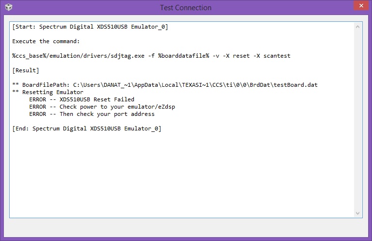

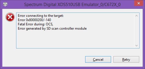

I have been using CCS v3.3 for years on a proprietary platform with the XDX510 USB emulator to debug 4 c6727 DSPs.  We recently switched to CCS v 6.1.1 and although I can connect with our single DSP platform I am getting an error trying to connect with any DSPs on our multi-dsp platform.  I am attaching two error dialogs.  One occurs when trying to connect and the other occurs when I  tun the "Test Connection".  I have also included the auto generated .dat file used to connect to the board.
Any Ideas of things to try?
    Have you tried using the SDConfigEx Utility? What is the result when you try to do an Emulator Reset and Test from the utility?

  • Here is the result using SDConfigEx to do and emulator reset and test.
    ** Using emulation application from directory d:\ccstudio_v3.3\drivers
    **Emulator is reset
    ** Checking for a valid emulator/eZdsp
    $$ You are connected to:
    $$ EmuProductName=XDS510USB
    $$ EmuPortAddr=0x510
    $$ EmuPortMode=USB
    $$ ProductId=510
    $$ ProductVersion=84
    ** Checking emulator/eZdsp scan connection
    ** Emulator Test **
    $$ EmuPortMode=USB
    $$ ProductId=510
    ** Emulator Scan Test
    -- Found JTAG IR length of 216
    -- Found 8 JTAG device(s) in the scan chain
  • Can you try running the same tests with the SDConfigEx utility that comes with CCSv6?
    ki
  • I ran the test with the SDConfigEx utility that came with version 6 with same results that look good.
    I went back to the ccxml files I had created for the board and tried launching them again and they all work fine now. Not sure what the problem was but it is all working as it should. I can disassemble and view memory. Thanks for your help, I will close this now.
