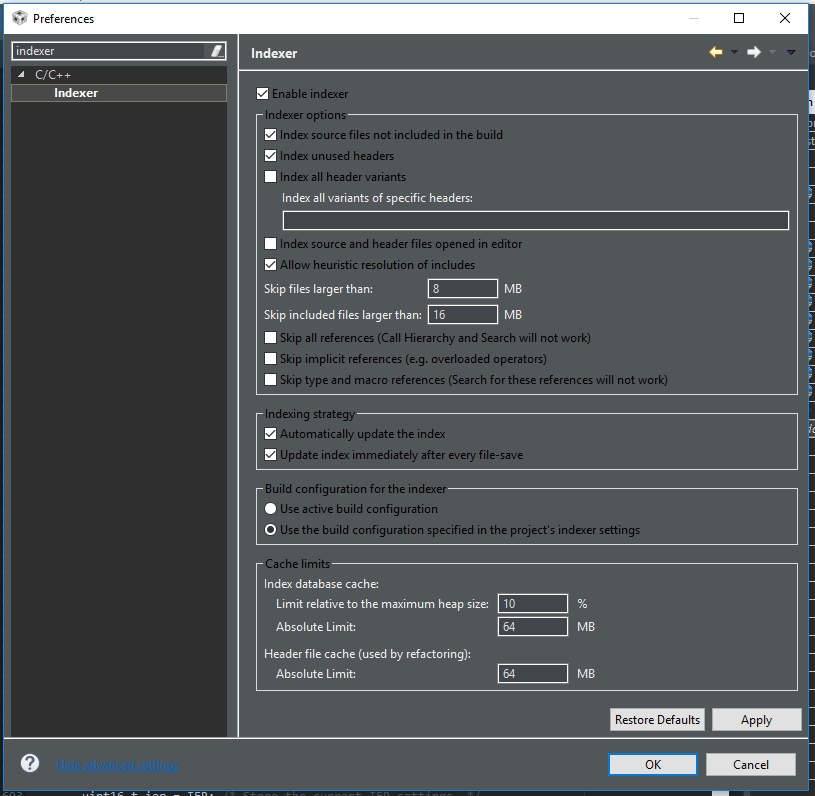

    Also check the indexer and content assist settings at both the workspace and project settings. Note that they are hidden by default and you'll need to "Show Advanced Setting" (option available at the lower left corner of the dialog) to expose them:
  • Hi Ki,

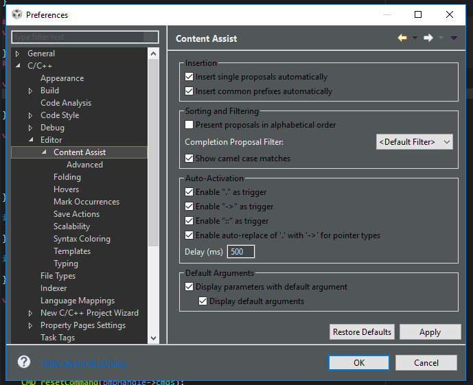

    I have my settings as below. The problem is across all projects in my workspace where I have multiple C2000 and MSP430 projects - some of the latter being example projects directly created from MSP430Ware.
    Other things that I'm guessing are related to the indexer work OK, such as syntax colouring for variable, function and object member usage, enum usage, etc
    Screenshots of the global content assist preferences, the global indexer settings and the project specific index settings (I think all the different projects' settings match this):

  • Damn, I feel pretty silly. Somehow (fairly certain it wasn't manually changed as I didn't previously know what it did) , the Parsing-based proposals line under Window->Preferences->C/C++->Editor->Content Assist->Advanced, was unticked.
    Ticking this item's box corrects the issue.
    Mostly. Search is still behaving slightly strangely (opens a new search results view each time I search and doesn't close the search panel itself after finishing), but all the stuff I believe was related to the indexer is solved by this small thing! :-D
    I worked this out by opening a second CCS window that used the same project in a new workspace and comparing the workspace settings between each of the instances - changing the next different setting, applying the change, restarting CCS and then testing the behaviour.
    Thanks for your help Ki
