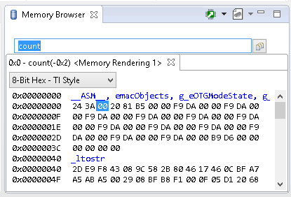

    With CCS 6.1.3 under Windows and a Tiva device found then when type the name of an integer variable into the memory browser then the memory browser displays the memory address which is the value of the variable.
    E.g. if the integer global variable count has the value 2, then typing count into the memory browser displays memory starting at address 2 (which is in flash for the Tiva device):
    Whereas typing &count into the memory browser displays the memory at the address of the variable:
    Not sure if this is a bug, or the intended operation of the memory browser.
  • Chester is correct.
    Typing the symbol name in the memory browser displays memory at the value of the symbol (equivalent to selecting "View Memory at Value" from Expressions view). Typing &symbol displays the memory at the address of the variable (equivalent to selecting "View Memory" from Expressions view).
