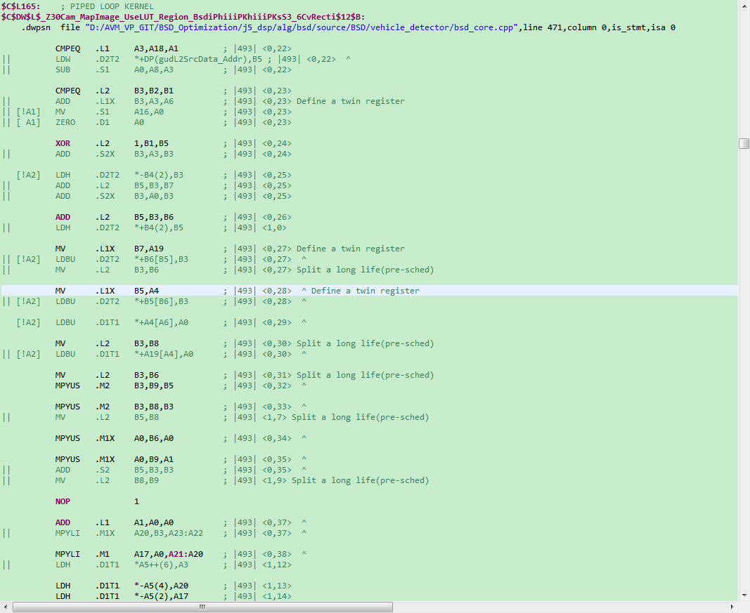

and the assembly part as follow:
note that: the input px and py parameters has been used with restrict keyword, as the line 490 was the main reason, try to add restrict keyword for variable po,p1,p2,p3 is unusefull, the main point is point multiplication in line 490 and 491 can't be paralleled, i have also tried to use _dotpu4 , failed.
so,  how to reduce the  Loop Carried Dependency Bound base on the assembly profile?

  • i must say that to optimize the line 490, the pointer p0,p1,p2,p3 wasn't used with restrict key word, while i did use it ,the value of Loop Carried Dependency Bound not reduced but increased, meanwhile, i have tried to calculate the variable of one_sub_dx*one_sub_dy in advance, it works, so the main reason is i can't calculate the value of p0,p1,p2,p3 in advance , how can i do to optimize the Loop Carried Dependency Bound?
    anyone can help?

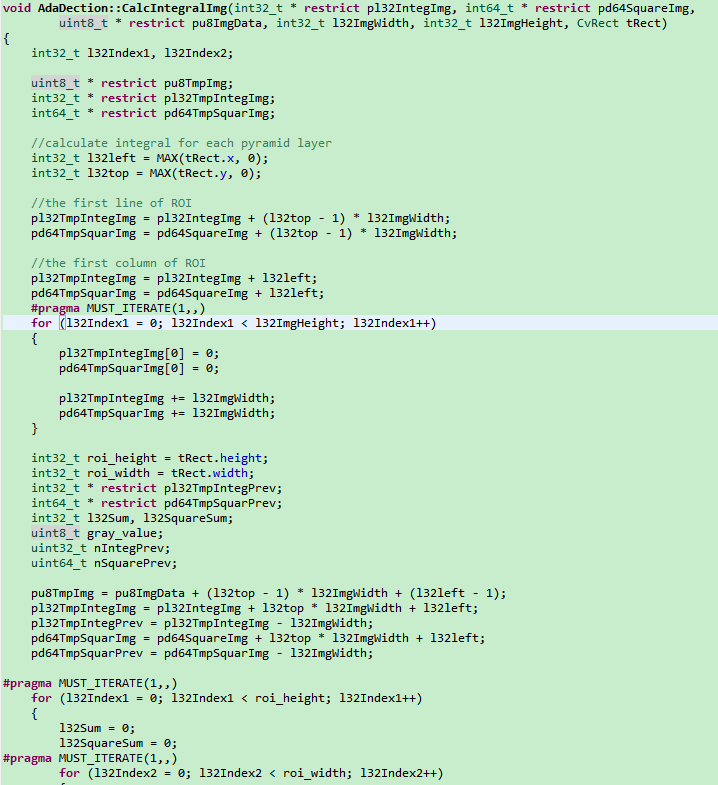

  • Can you show us the whole function? It's hard to tell without seeing the variable declarations. The following code

    The whole function was following:
    whether i add the restrict or not , it desn't work.
    So, how to process?
    Thanks for your assistance!

  • Hi,George.
    I will post the source code with the insert code tool , the compiler version is V7.4.2 while the target processor version is 6740, the output format of this project was set as ELF, the bulid option i have used for this source code file are only -o3,-mw,-mt and -k.

  • Your source code does not build as is.  For instance, I don't have the definition of the class AdaDection, so I commented that out.  I made a few other similar guesses.  And these guesses somehow cause the problem to go away.  Please send the preprocessed file, and show all the build options exactly as the compiler sees them.  That removes all the guesswork.

  • Hi,George
     Sorry for my source code can't be build, actually you don't need the definition of the class Adadection, i have repreprocessed it as follow, and the the build options i have show it before, -mv6740, --abi=eabi, -O3, -g ,-mt,-k, i have choose for this source code. So is there anything of the build option  i haven't shown for you?
    void CalcIntegralImg(int32_t * restrict pl32IntegImg, int64_t * restrict pd64SquareImg, uint8_t * restrict pu8ImgData, int32_t l32ImgWidth, int32_t l32ImgHeight, CvRect tRect)

    		pd64TmpSquarImg += l32ImgWidth;
    	int32_t roi_height = tRect.height;
    	int32_t roi_width = tRect.width;
    	int32_t * restrict pl32TmpIntegPrev;
    	int64_t * restrict pd64TmpSquarPrev;
    	int32_t l32Sum, l32SquareSum;
    	uint8_t gray_value;
    	uint32_t nIntegPrev;
    	uint64_t nSquarePrev;
    	pu8TmpImg = pu8ImgData + (l32top - 1) * l32ImgWidth + (l32left - 1);
    	pl32TmpIntegImg = pl32IntegImg + l32top * l32ImgWidth + l32left;
    	pl32TmpIntegPrev = pl32TmpIntegImg - l32ImgWidth;
    	pd64TmpSquarImg = pd64SquareImg + l32top * l32ImgWidth + l32left;
    	pd64TmpSquarPrev = pd64TmpSquarImg - l32ImgWidth;
    #pragma MUST_ITERATE(1,,)
    	for (l32Index1 = 0; l32Index1 < roi_height; l32Index1++)
    		l32Sum = 0;
    		l32SquareSum = 0;
    		for (l32Index2 = 0; l32Index2 < roi_width; l32Index2++)//line 372
    			gray_value = pu8TmpImg[l32Index2];
    			nIntegPrev = pl32TmpIntegPrev[l32Index2];
    			nSquarePrev = pd64TmpSquarPrev[l32Index2];
    			l32Sum += gray_value;
    			l32SquareSum += (gray_value * gray_value);
    			pl32TmpIntegImg[l32Index2] = nIntegPrev + l32Sum;
    			pd64TmpSquarImg[l32Index2] = nSquarePrev + l32SquareSum;
    		pu8TmpImg += l32ImgWidth;
    		pl32TmpIntegImg += l32ImgWidth;
    		pl32TmpIntegPrev += l32ImgWidth;
    		pd64TmpSquarPrev += l32ImgWidth;

  • Your code still won't compile, #include <stdint.h> is missing as well as the definition of MAX and the definition of CvRect. The following file
    #include <stdint.h>
    #define MAX(x,y) ((x) < (y) ? (y) : (x))
    typedef struct CvRect_t
       int32_t x;
       int32_t y;
       int32_t width;
       int32_t height;
    } CvRect;
    	int32_t l32Index1, l32Index2;
    	uint8_t * restrict pu8TmpImg;
    	int32_t * restrict pl32TmpIntegImg;
    	int64_t * restrict pd64TmpSquarImg;
    	//calculate integral for each pyramid layer
    	int32_t l32left = MAX(tRect.x, 0);
    	int32_t l32top = MAX(tRect.y, 0);
    	//the first column of ROI
    	pl32TmpIntegImg = pl32IntegImg + l32left;
    	pd64TmpSquarImg = pd64SquareImg + l32left;
    	for (l32Index1 = 0; l32Index1 < l32ImgHeight; l32Index1++)
    		pl32TmpIntegImg[0] = 0;
    		pd64TmpSquarImg[0] = 0;
    	uint8_t gray_value;
    		l32Sum = 0;
    		l32SquareSum = 0;
    is probably the closest to what you posted. However, CGT 7.4.2 compiles this just fine. There are two pipelined loops in my output, the first has a dependency bound of 1, the second has a dependency bound of 0. There must be something you do differently, but without knowing what that is we will not be able to help you, I'm afraid.
