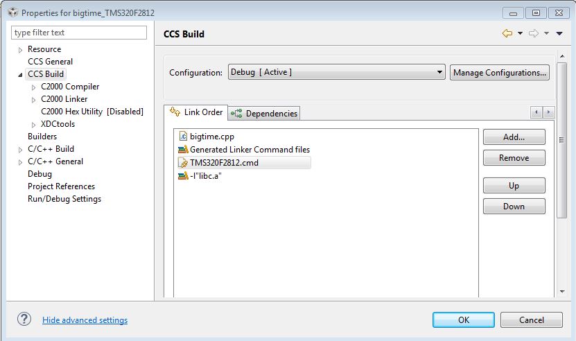

  • I'm not allowed to send you my Project, but i was able to reproduce the problem with an example project.
    I found out that it only happens when C++ is used int the Project. In this project no "epilog.obj" is generated, but i dont know why.
    However it shows exactly what my Problem is: redefinition of RTS functions...
    redefinition_demo_project.zip
  • The problem with the example project is the link order.  The linker should process your custom link command file TMS320F2812.cmd after the link command file(s) auto-generated by the SYS/BIOS configuration.  And the compiler runtime support library should appear last of all.
    Right click on the project name and select Properties.  Look in the lower left corner.  If it says Show advanced settings, then click on that.  In the pane on the left, click on CCS Build.  In the pane on the right, select the tab Link Order.  Click Add.  Click Select All, then click OK.  Change the link order of a file by selecting it, then clicking the Up or Down buttons.  Make TMS320F2812.cmd appear 2nd to last, and -l"libc.a" appear last.  See the screen shot below.  Click OK.  Rebuild.  The problem goes away.
    Thanks and regards,
    -George
  • This solved the problem!
    Thank you!
