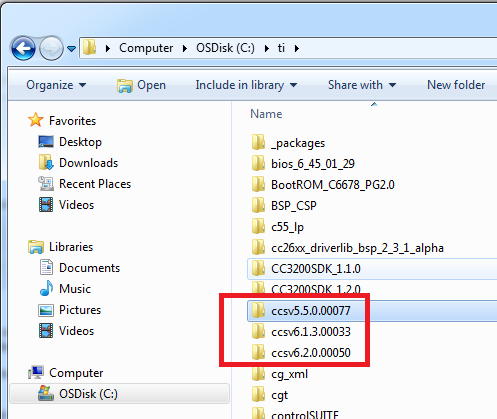

I personally do C:\ti\<version number>
In the screenshot below, I have 3 installations of CCS co-existing. All use the format I mentioned above:
