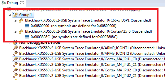

  • Did you first create a fixed group for the ARM and DSP?
    http://processors.wiki.ti.com/index.php/Multi-Core_Debug_with_CCS#Fixed_Groups
    You just need to enable global breakpoints for the group. That would make breakpoints global across all cores in the group (in your case it would be the ARM and DSP you put in the group)
  • Yes, I tried to enable global breakpoints after creating a fixed group. Also I ran DRM_setDP0ForGlobalBreakpoint function.
    But, "Enable Global Breakpoints" menu items are not enabled for ARM and DSP at the same time.

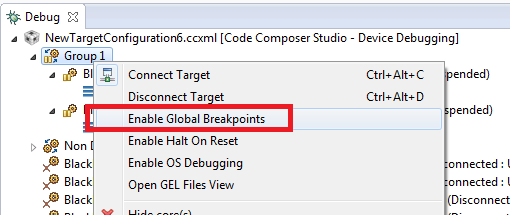

  • I tried this out on my multi-core target which has multiple A15 and C66x devices.
    See my steps below.
    I created a fixed group consisting of one A15 and one C66x:
    Next, I right-click on the group and select the option to enable global breakpoints in the context menu:
    Once i have done that, you can see that global breakpoints are enabled for both cores in the group:
    Can you apply these steps in your environment?

  • Thanks for your reply.
    I think my steps were similiar to yours.
    Please check my steps if I made a mistake.
       1. select "New" -> "Target Configuration File"
       2. set new target configuration file
          Connection : Blackhawk XDS560v2-USB System Trace Emulator
          Board or Device: 66AK2H12
       3. select "Launch Selected Configuration"
       4. make fixed group for C66xx_0 and arm_A15_0 by selecting "Group core(s)"
       5. connect C66xx_0 and arm_A15_0 by selecting "Connect Target" for Group 1
       6. select "Enable Global Breakpoints" for Group 1
          -> C66xx_0: Global breakpoint on
         -> arm_A15_0: No change. "Enable Global Breakpoints" menu disabled.

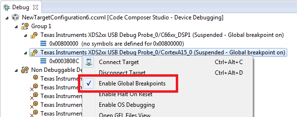

    I can repeat that using CCS 6.2.0.00050 and a EVMK2H with the XDS2xx USB Onboard Debug Probe:
    When in this state of "Global breakpoint on" only reported for the C66 core, cross triggering is not working in that if one core stops on a breakpoint, the other core continues to run.
  • I tried using an XDS200 to see if that would make a difference but it did not. The global breakpoint option for A15 is not greyed out and I tried setting a breakpoint on just for the DSP and when the DSP stops on the BP, the ARM was halted also via cross-triggering:

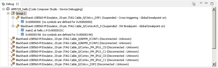

  • Ki-Soo Lee said:
    Since I am not using an EVMK2H, perhaps this issue is device specific.
    Using CCS 6.2.0.00050 I was able to get cross-triggering to work on an AM5728 Rev 1.1:
    i.e. it does appear to be a device specific issue.
