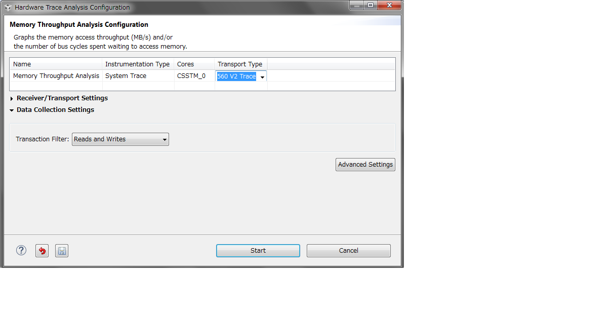

I'm using K2G EVM with CCSv6.1.3. I tried MemoryThroughput Analysis (CCS menu : Tool->Hardware Trace Analyzer->Memory Throughput Analysis) with Blackhawk xds560v2 emulator, but it did not work.
The following is my configuration.

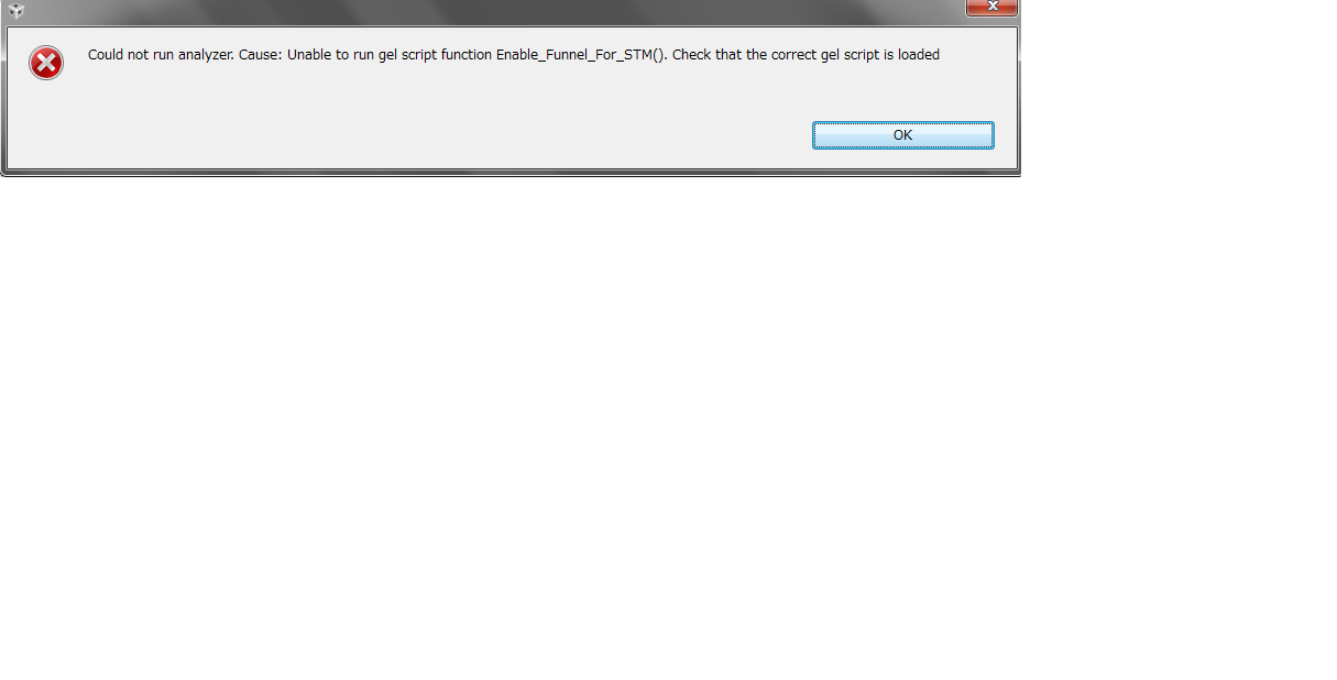

And when I push the start button, I saw the following error:
Do you have any suggestion on this ?

  • Naoki,
    Thank you for the detailed report. I can reproduce this here and filed the bug number DBGTRC-3235. Its status can be checked in the link SDOWP in my signature below (give it about 1/2 hour for the databases to sync).
    Unfortunately no other workaround can be done other than using ETB instead.
    I apologize for the inconvenience,
