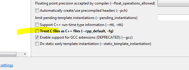

I have some .C files in my C++ project, and in order to make them build, I've uncheck the box to revome the --cpp_default option.
The build is ok but in run-time, the program stucks in the TI_auto_init() call. I've replaced the call to the old TI code, and I see that some init call have null pointer or stuff like that.
Then I've checked the box this time and use some extern "C" {...} to make them build (the solve the mingling thing I guess), still the same result on TI_auto_init().

  • I doubt that --cpp_default is the issue here. The only thing that this option does is treat files with extension .c as if they had extension .cpp; if your program compiles, it's unlikely you need to mess with --cpp_default

  • If you need the --cpp_default option to build a file, then that file is a C++ file, not a C file, despite the file extension.

  • « If you need the --cpp_default option to build a file, then that file is a C++ file, not a C file, despite the file extension »
    R: maybe this is not the option I'm talking about, this is this option I were refering:
    Anyway, finally I've got the problem and you were right, it seems nothing related to this option. The problem was a singleton pattern stuff that I'd added along the .C files stuff. But I still don't know why it interferes with TI_autoInit(). The code change is:
