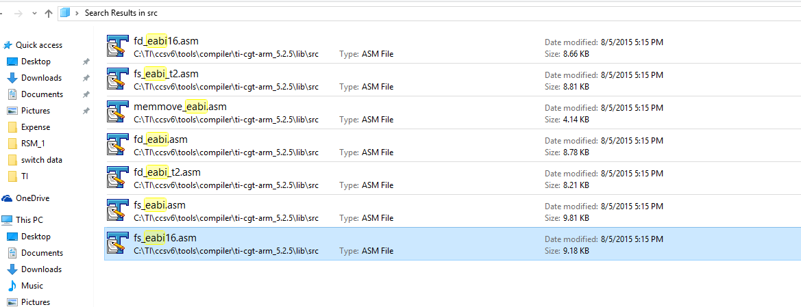

    I found the Lib source ASM files .
    I really don't know what file and where in the file should get update with remedy !
