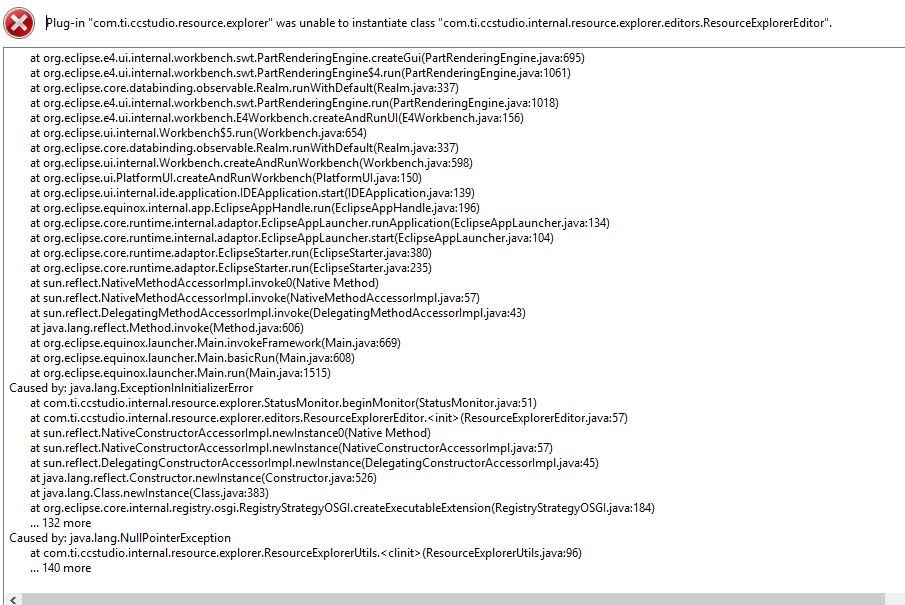

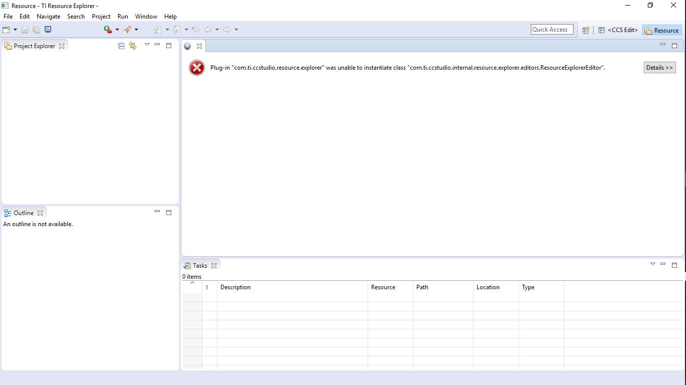

I am trying to install CCS6.2 on a WIN10 x64 machine. CCS6.1 is installed and worked at the end with issues regarding the XDS sources
after install and first check for updates and installing them the following is the result
even the View menu is missing
What can be done ?
If I resinstall should I avoid to install any update?
    Do you happen to know which updates were installed?
    Although inconvenient, I would suggest trying a reinstall. Be sure to uninstall the previous installation first by deleting the directory completely.Then reinstall CCS 6.2 and verify that the View menu, Resource Explorer etc work as expected before installing any updates. Then install only updates that you believe are required and relevant for your development. Perhaps that will help isolate what, if anything, related to updates is causing a problem.
  • I switched back and reinstalled CCS6.1.3 as the difference is too big for older projects to migrate to 6.2
