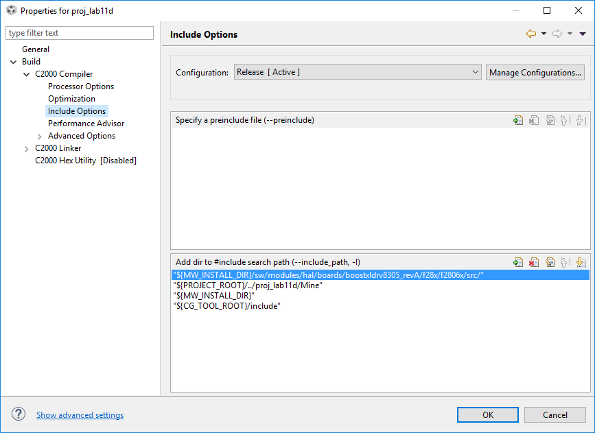

I have tried to export my project using Export -> General -> Archive File, this is working, however when I try to import it to clean new workspace files are missing from Motorware and others ..
What is the best way to export everything with all related files ? so I can open it easily without loosing any of the files that are in this project ?
Bottom line I did not suceed to IMPORT and get clean compilation after doing the EXPORT
please help

  • The closest thing that we would have to this today would be the linker map file that is generated as part of the build. It would list all the .obj files (1 to 1 mapping with the .c files) as well as any libraries. Unfortunately it would not list the .h files. We would have to create a new tool to pull everything together. I can log a request for this.
    The best thing to do is to have the project and all the necessary files in a source control repository. That way you can easily replicate the environment on any PC with ease. Even if not sharing with other users it is still a good practice to protect your work.
    John
  • Do you mean to add it here:
    I can add the VARIABLE but not its value ?

  • Roee,
    That is an example of where you would use the variable.  Basically there you are specifying the value of MW_HOME to be one of the places that the compiler looks for header files.
    To define MW_HOME you can do this in 2 different locations.
    You can define it in the project itself:
    Or if it is something that you want to use across projects you can define it in your workspace.
    Go to Window -> Preferences
    Defining in the workspace is best if you are going to share the project with different uses or use it across different machines where the location of MotorWare may be different.  If you are going to check the project into source control then you definitely want to do it this way.
    There is more information on how to make projects portable here: http://processors.wiki.ti.com/index.php/Portable_Projects

  • This is not working for me
    See below:
    I have opened new workspace, imported ZIP file created from working project and then did the following:
    Why ??
    Roee
  • Where is the file physically located?
    What do your include paths look like?
    Also if you look at the --include_path options being passed to the compiler in the console view you can see exactly where the compiler is searching for files. Either your variable is off or the way it is used in the include paths is off.
    John
    Files are located here:
    C:\Users\roeeb\workspace_V10
    You can see here:
    Here is the logfile: (attached)
    Roee

  • OK
    I could fix this by applying many changes in paths and copying files
    However I get now 2 warnnings? how can I fix them ?
    Also found out that the current HEX file is smaller than the original one why ?
    See attached photos
    paths are not relative (fixed...)
    Roee
  • The first warning is due to the include path ${PROJECT_ROOT}/../../../src
    That is resolving to C:\Users\src which does not exist on your computer.  You can get rid of the warning by adjusting the path to make it point where you intended.
    The second warning is because the project is set to use a version of the compiler that you don't have installed on your PC.  CCS then uses the closest match it can find.  This warning is pretty common as many software packages are setup that way.  To resolve this you can click on General in the project properties tree and change the compiler version to one that you have installed.  For my the project was set to use 6.2.3 but CCS is instead using 15.12.3.  That is why you see [15.12.3] beside it.  If you put your mouse over the warning it will give you more info.  Just click on the drop down and change the compiler to 15.12.3 and the warning will go away.
  • OK guys,
    You gave me inspiration
    Fixed all
    I did this to make it relative path:
    However now I get new messages like this:
