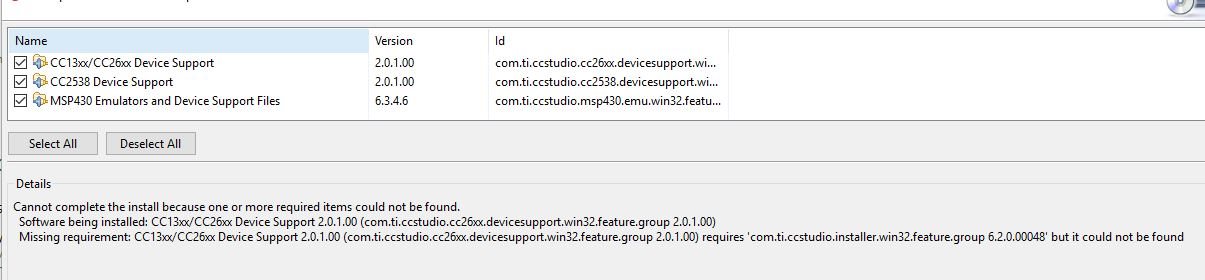

Hi all,
I'm not able to update to the latest version of the tools, and I don't understand the reported error.
Here is the screen capture:
Hi all,
It looks like that update is only available for CCS 6.2.0. From your tags it looks like you're still running CCS 6.1.x.
