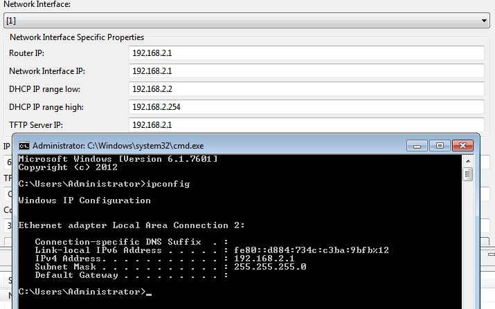

  • Hi, thanks for your reply. I think I config network ok, it recognized target, and the log is listening. I don't know why the state don't change?
    P/s: the picture and log is different ip because i coppied log when config follow wiki.
  • log error says bind failed so it is not setup properly. Can you paste the result of your ipconfig?
  • Because i have 4 connection interface, i configed one connect to target, still three is blind.
  • looks fine to me, delete the logs and run it again and then send me the two full log file and let's see what's going on here.

  • it is not lining up with the ip you have shown in the screenshot, maybe your ini files are corrupted.
    check to make sure the opendhcp and opentftp processes are killed, then use the "restore default configuration" button and try again
  • I restart computer, and restore default ip is 192.168.100.1. So I setup my network have same ip.
