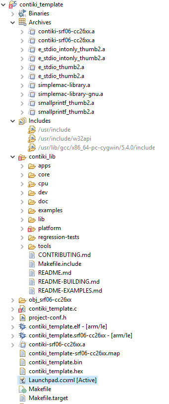

My HW setup is CC1310 Launchpad with built-in XDS110. Software tools are following: Windows 10, CCS  Version: 6.1.3.00034, GCC ARM toolchain v5.4, CygWin make utility. My current goal is to deploy Contiki OS to CC1310. I downloaded git repo and modified makefile to build debug configuration(optimization –O0 and –g flag), application code is cc26xx-demo from examples folder. CCS project is configured for external makefile. Now I have following project structure:

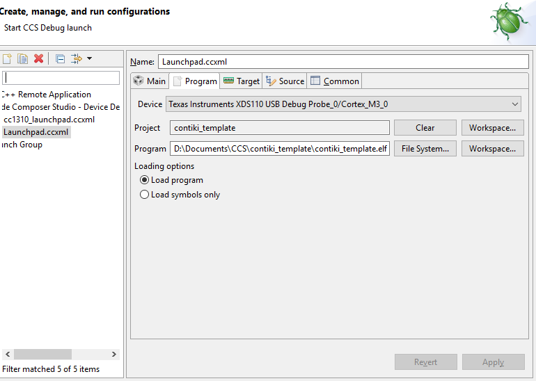

It builds ok and works as supposed to, when downloaded to the MCU. The problem appears, when I try to debug this code. I use following debug target configuration.

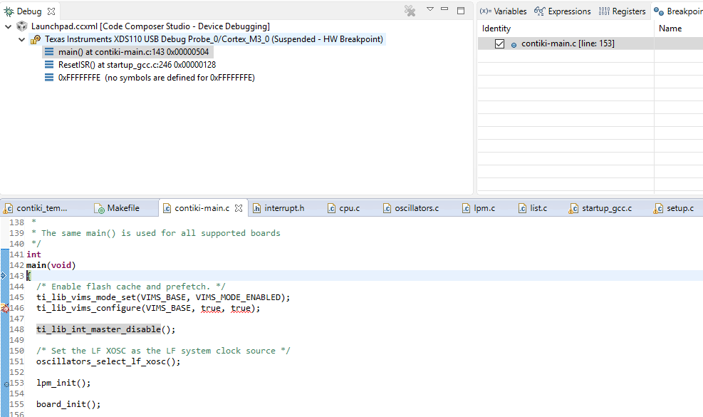

After device is flashed I get following window and everything seems to be OK.
I can place breakpoints, navigate through code or control program execution with “Step intro”, “Step over” and “Step return”. But when I hit “Resume” button, all breakpoints are ignored so I cant control program flow. After pushing “Suspend” button following message appears: "No source available for 0x1000486".

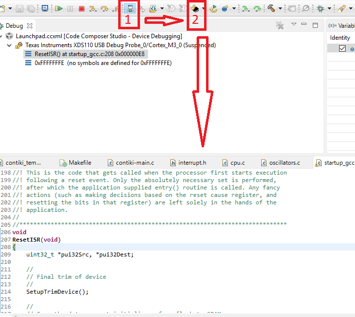

After re-connect and device reset (sequence shown in the following figure) debugger will find the corresponding code, but after resuming and suspending program execution the error will repeat.

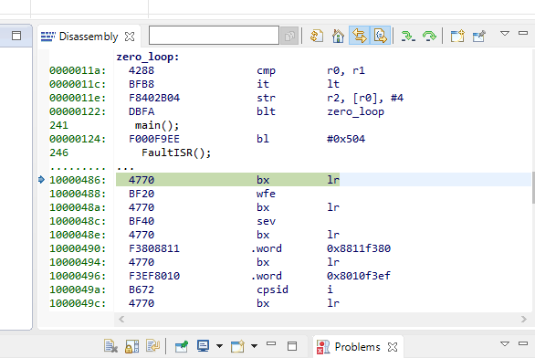

    The message "No source available for 0x1000486" in itself does not indicate a problem. This type of message is expected when the code is halted at an address for which there is no source code association. You can open the Disassembly view and check what is at that address and try to continue debugging from there.
    When I suspend program flow it shows me following, anyway, few seconds later after suspending error 1170 appears.
    I wonder, is that OK to have such large pointers(0x10000486) on my device which have only 128k of flash?
    There is something triggering a fault, as the program is halted in FaultISR(). It may be related to how the application itself is set up, the linker command file being used etc. Unfortunately I don't have enough knowledge about this application to be able to provide more precise answers. As I mentioned before, the experts in the Wireless Connectivity forum might have other suggestions so I would suggest posting there.
