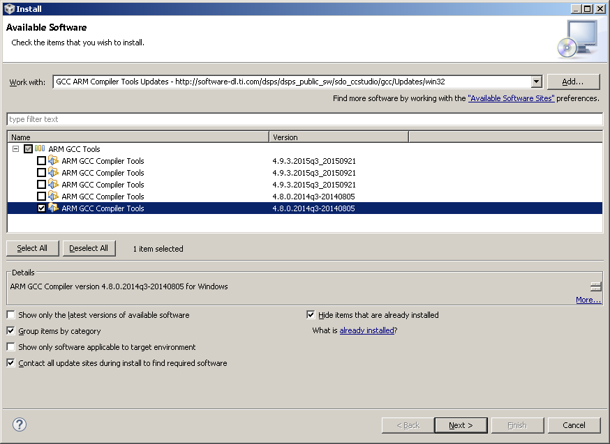

    Looking at CCS 6.2.0.00050 under Windows 7, in which GNU v4.9.3 was originally installed, found that a CCS 6.2 installation supports multiple versions of the GCC ARM compiler.
    From Help -> Install New Software the CCS updates only had the older version v4.8.4 available:
    I has able to use CCS to install v4.8.4 using the above update. Note that since I already had v4.9.3 Eclipse wouldn't let me install v4.8.4 until I had first used Help -> About Code Composer Studio -> Installation Details -> Installed Software to uninstall the v4.9.3 Eclipse feature. See Installing Older Versions for the reason.

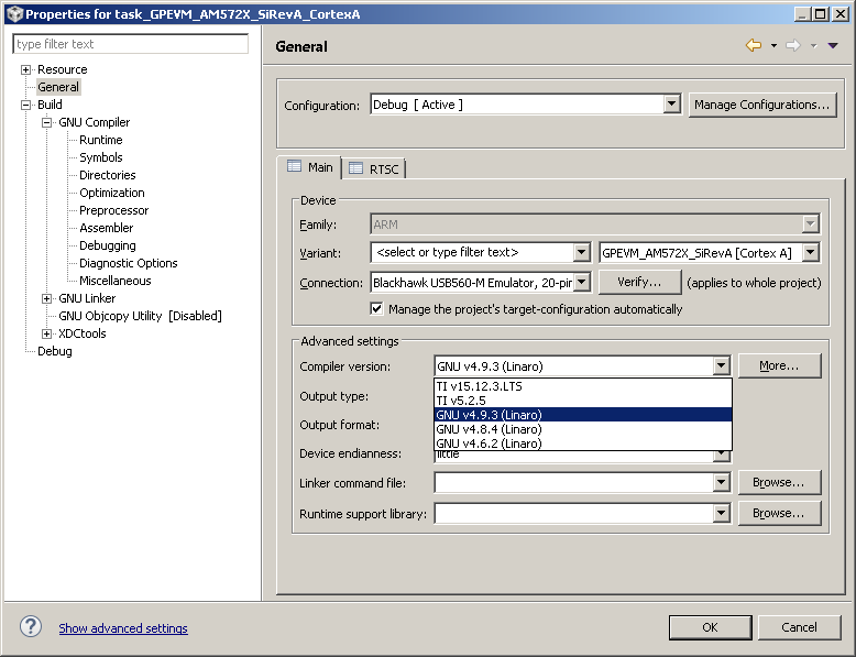

    I also found that if manually install over GCC ARM versions into the <CCS_install_root>\ccsv6\tools\compiler directory that upon a re-start that CCS will detect the compiler and allows its selection. E.g. after also manually installing v4.6.2 into <CCS_install_root>\ccsv6\tools\compiler\gcc-arm-none-eabi-4.6-2012q4 then CCS allowed the selection of different GCC ARM compilers from the project properties:
  • Hello Chester,
    Thanks for your hints. I can basically reproduce your first screenshot. As described, I could not install 4.8.0 before uninstalling 4.9.3.
    I could uninstall 4.9.3 and (after restarting CCS) could install 4.8.0 (and restart CCS again).
    Result:
    Version 4.8.4 has not been offered to me, but since the install of "4.8.0", I can select "GNU v4.8.4 (Linaro)" according in your second screenshot. The property window still lists my previously installed "4.9.3" (like in the screenshot), but I get errors when selecting the uninstalled v4.9.3 (apparently it has gone...).

  • Benedikt said:
    Yes, it is a SYS/BIOS project.
    I think the problem is that when the GCC compiler version is changed that CCS sets the RTSC Target to the wrong value. E.g. with CCS 6.2.0.00050:
    1) Import the task_GPEVM_AM572X_SiRevA_CortexA SYS/BIOS example, and select compiler version GNU v4.8.4 during the import. The RTSC Target is set to "gnu.targets.arm.A15F" and the imported project builds correctly using GNU v.4.8.4.
    2) In the CCS project properties change the compiler version from GNU v4.8.4 to v4.9.3. The project now fails to build reporting:
    xdctools_3_32_01_22_core\gmake.exe: *** Deleting file `package.mak'
    js: "C:/ti/bios_6_45_01_29/packages/ti/targets/arm/elf/IArm.xs", line 77: Error: template generation of 'compiler.opt' failed: Error: The compiler in C:/ti_ccs6_2_0/ccsv6/tools/compiler/gcc-arm-none-eabi-4_9-2015q3 is not compatible with this version of TI-RTOS or SYS/BIOS. Please use Arm compiler 5.2.2 or newer.
        "./package.bld", line 54
    3) On looking at the RTSC project properties see that the act of changing the GNU compiler version has caused CCS to incorrectly change the Target from "gnu.targets.arm.A15F"  to "ti.targets.arm.elf.A8Fnv". This is a change of the GNU to TI compiler tools, and a change of a Cortex-A15 to Cortex-A8!
    Changed the Target back to "gnu.targets.arm.A15F" and the project now builds with GNU v4.9.3
    [To get this example to link with GNU v4.9.3 had to set the -mfpu option to vfpv4 due to SYS/BIOS examples for Cortex-A15 generate linker errors in CCS 6.2.0 due to the FPU related flags passed to the GCC linker]
    Chester,
    I could reproduce this issue and have filed it in our system as CCSIDE-2988. Thank you for bringing this to our attention.
