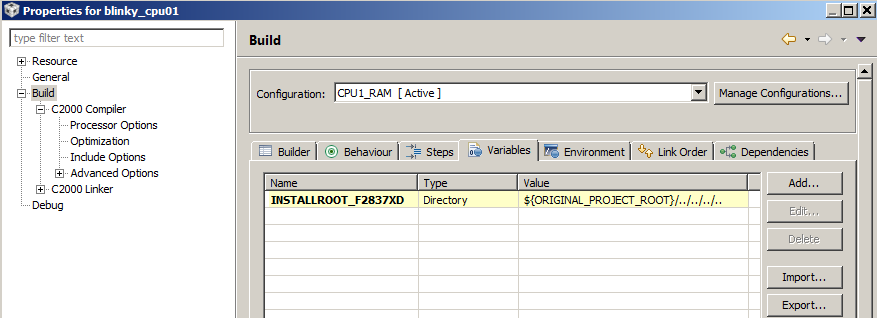

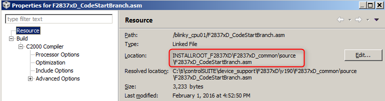

  • Hank Barta said:
    Examining the file properties I see the file path is
    PROJECT_LOC\..\..\..\..\..\..\..\opt\ti\controlSUITE\device_support\F2837xD\v190\F2837xD_common\source\F2837xD_CodeStartBranch.asm
    That is surprising because when I import example projects in Windows, and examine the file property of F2837xD_CodeStartBranch.asm, I see this:
    where INSTALLROOT_F2837XD is set to the root of the F2837XD device support folder relative to the original project root directory as shown below:
    During project import, CCS looks at the original project location and sets the root folder relative to it. That way even if users install ControlSuite to different paths, the INSTALLROOT_F2837XD variable will always be set to the correct directory using relative paths, and will allow users to import projects no matter where their ControlSuite is installed.
