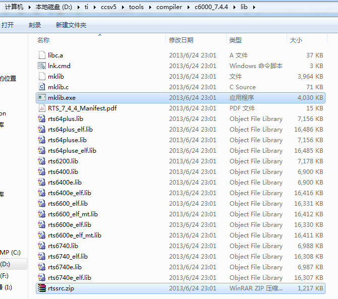

So I find the lib file in \ti\ccsv5\tools\compiler\c6000_7.4.4\lib,
there is a rts64plus_elf.lib and a rts64plus.lib.
I thought the rts64plus.lib is COFF format, and the rts64plus.lib is ELF format.
So, I changed the name of rts64plus_elf.lib to rts64plus.lib, and rebuild the project, but got:
So, I think the rts64plus_elf.lib doesn't have the SK_APIs.
     I find the source code in the ti\ccsv5\tools\compiler\c6000_7.4.4\lib\

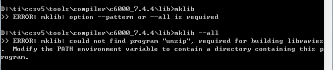

     The rtssrc.zip is the package of the source code. And there is a mklib.exe. I tried the mklib.exe but it occured some errors. I've use mklib -h to see the options of the command, but didn't get the right way to compile the source code.
    I've also open a new CCS "Static Library" project and add all the source files to the project. But when I build the project, many errors occured.
    Can TI give me some guidance on recompile the source code?
    And can TI provide me the rts64plus.lib in ELF format?
