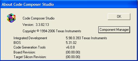

  • Hi Mariana,
    Thanks for replying.
    Previously I was using the CCS version that comes with the EVM. However after reading your reply I try to use the full version. The version number stated in the "About" window is as below:
    However the Component Manager seems to reflect a different version number:
    Which piece of information should I trust?

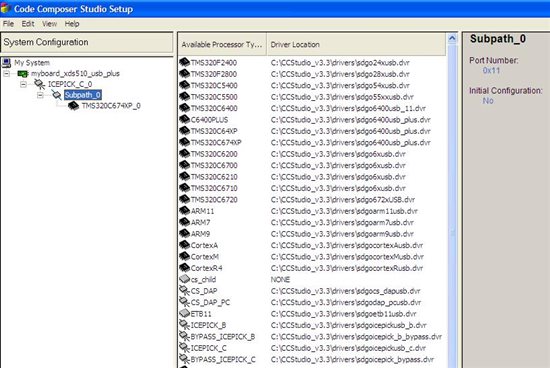

    I also tried to connect to my custom board again with this version of ccs using the same configuration mentioned in my previous post and got the following error:
    Error connecting to the target:
    Error 0x80000244/-2131
    Fatal Error during: Register, Initialization, OCS,
    Cannot access register at 0x00000000
    I/O Port = 510
    Board Name: myboard_xds510_usb_plus
    Cpu Name: ICEPICK_C_0
    Abort:  Close Code Composer Studio.
    Retry:  Try to connect to the target again.
    Cancel:  Remain disconnected from the target
    Diagnostic: Run diagnostic utility.
    Is there any other configuration I need to do to connect to my custom board?
  • Have you read http://processors.wiki.ti.com/index.php/XDS_Target_Connection_Guide
    This document gives information on designing a target board with emulation signal terminations, etc.  I think this is most likely the problem..  If the custom board only has a single 6747 on it, then the configuration in CCS is going to be essentially the same as with the EVM.  The need for adding an IcePick is dependent on whether the target has an icepick.  If you're using the same part as on the EVM, and the CCS configuration for the EVM has an IcePick, the CCS config for your custom board will also need an IcePick.

  • The version at the "about" that you pasted is still the EVM version, does not look like the full version.
    http://processors.wiki.ti.com/index.php/Getting_Started_Guide_for_C6747#Installing_CCS_and_Tools
    About the CGTools and DSP/BIOS, see page below and also:
    http://processors.wiki.ti.com/index.php/-mv_option_to_use_with_the_C674x
    Make sure that you have the everything selected for both  TMS320C64XX and TMS320C67XX in the component Manager - you need to re-start CCS3 for the changes to take place.
    But if the problem is the connection with the board, it is not about CGTools version or DSP/BIOS version, it is probably about CCS full version + driver updates + correct setup.
  • Hi Mariana,
    I don't understand why the "about" is still the EVM version. I uninstalled the EVM version and installed from the CCS CD ROM. Is it becauseI  didn't register online?
    What should I see in the "about" if it is a full version? And why is the component manager and the "about" should different version number as seen in the screen short in my previous post?
    Could be, go ahead and register your version.
    http://e2e.ti.com/support/development_tools/code_composer_studio/f/81/p/55905/198414.aspx#198414
     After you register your full version, install the latest Service Release (to get the SR you should go to Help-> Update advisor->Check for updates).
    Here are the versions that you should see according to the SR that you have installed:
    http://processors.wiki.ti.com/index.php/CCStudio_FAQ#Q:_How_can_I_find_out_which_CCStudio_3.3_Service_Release_number_is_installed.3F
    You need to have at least SR12, so get the latest.
