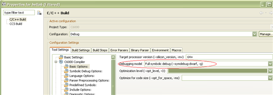

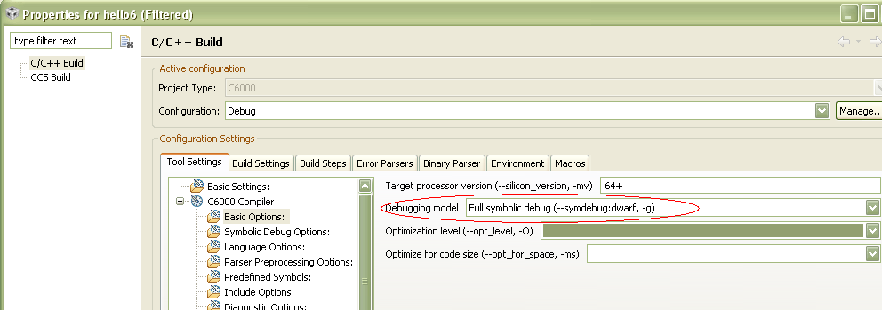

  • In case you were asking where the option is to enable -g, it is:
