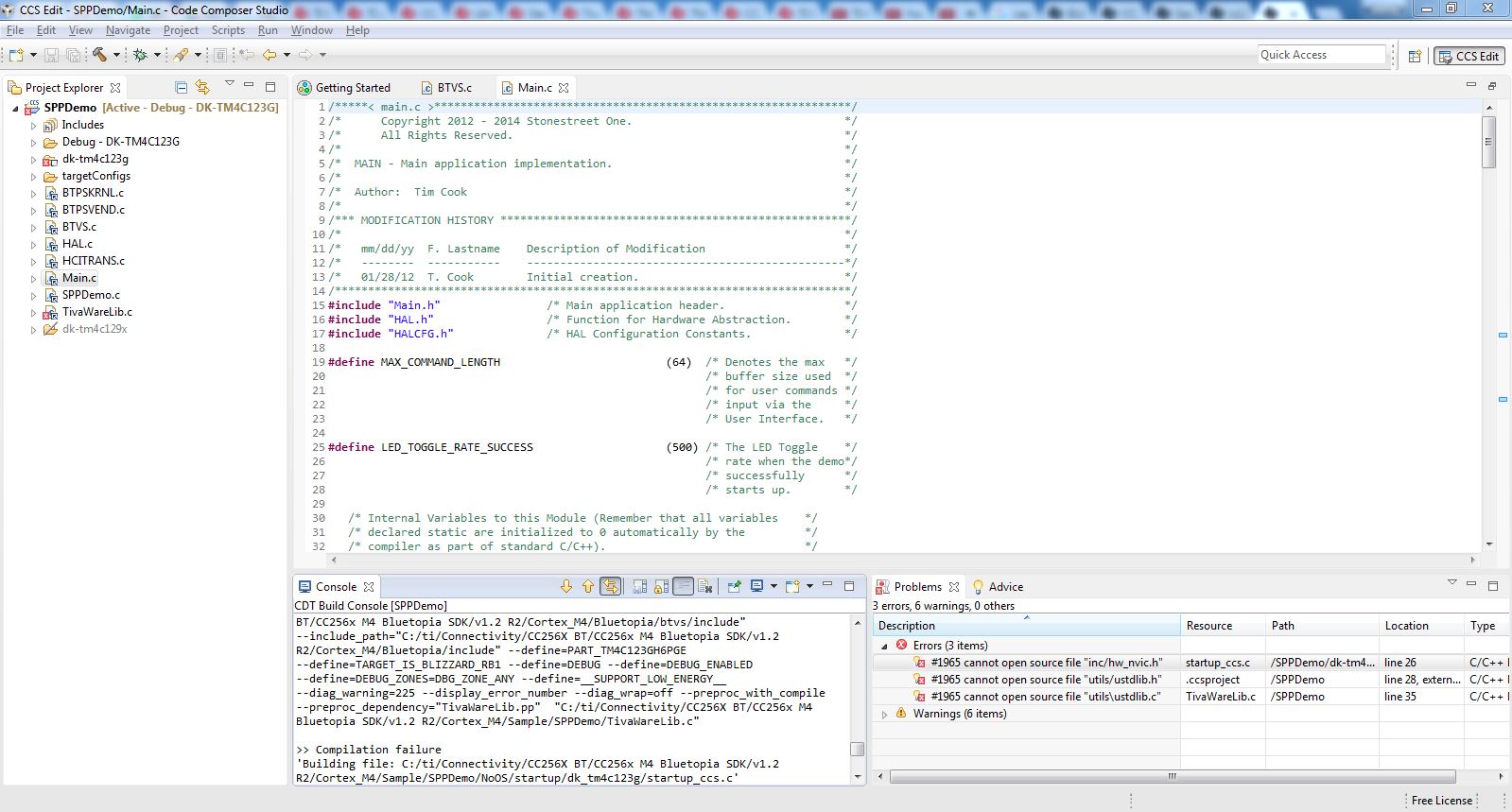

I am trying to interface CC2564 with TIVA evalboard. I am getting the following errors.
"C:/ti/Connectivity/CC256X BT/CC256x M4 Bluetopia SDK/v1.2 R2/Cortex_M4/Sample/SPPDemo/NoOS/startup/dk_tm4c123g/startup_ccs.c", line 26: fatal error #1965: cannot open source file "inc/hw_nvic.h"
"C:/ti/Connectivity/CC256X BT/CC256x M4 Bluetopia SDK/v1.2 R2/Cortex_M4/Sample/SPPDemo/TivaWareLib.c", line 35: fatal error #1965: cannot open source file "utils\ustdlib.c"
"C:\ti\Connectivity\CC256X BT\CC256x M4 Bluetopia SDK\v1.2 R2\Cortex_M4\Bluetopia\btpskrnl\NoOS\BKRNLAPI.h", line 28: fatal error #1965: cannot open source file "utils/ustdlib.h"
I am new to TIVA and Bluetooth. Initially I was trying with MSP430 but tried TIVA since I found more documentation about interfacing the BT eval board with TIVA.
    The compiler is generating these messages because it cannot find/open the header files mentioned above.
    http://processors.wiki.ti.com/index.php/Build_Errors_in_CCS#Error:_could_not_open_source_file_.22xxx.h.22
    You need to add the location of those files to the --include_path dialog in the Compiler's Include Options category (Project Properties->Build->Compiler->Include Options). Typically those folders (inc and utils) are in the root directory of TivaWare, so if you add the root directory of your TivaWare installation to the compiler's --include_path dialog, that should resolve the errors.
