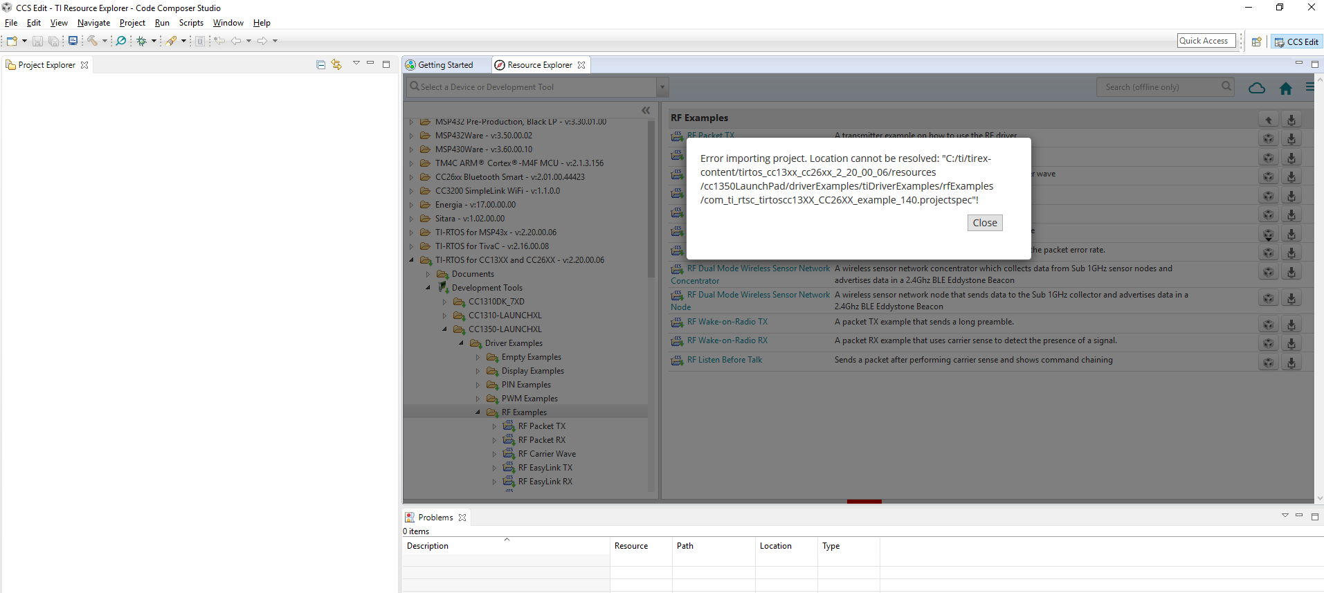

Hi everyone,
When i'm importing a programs  from resource explorer i'm getting an error as shown below, Please help me to solve this
  • Abhilash,
    Do you see the .projectspec file mentioned in the message box in the specified directory? If the TI-RTOS package was downloaded properly to c:\ti\tirex-content, then the file should be there. I just download that same package from Resource Explorer and clicked on the "Import to IDE" button in Resource Explorer to import a few examples and they all imported and built fine.

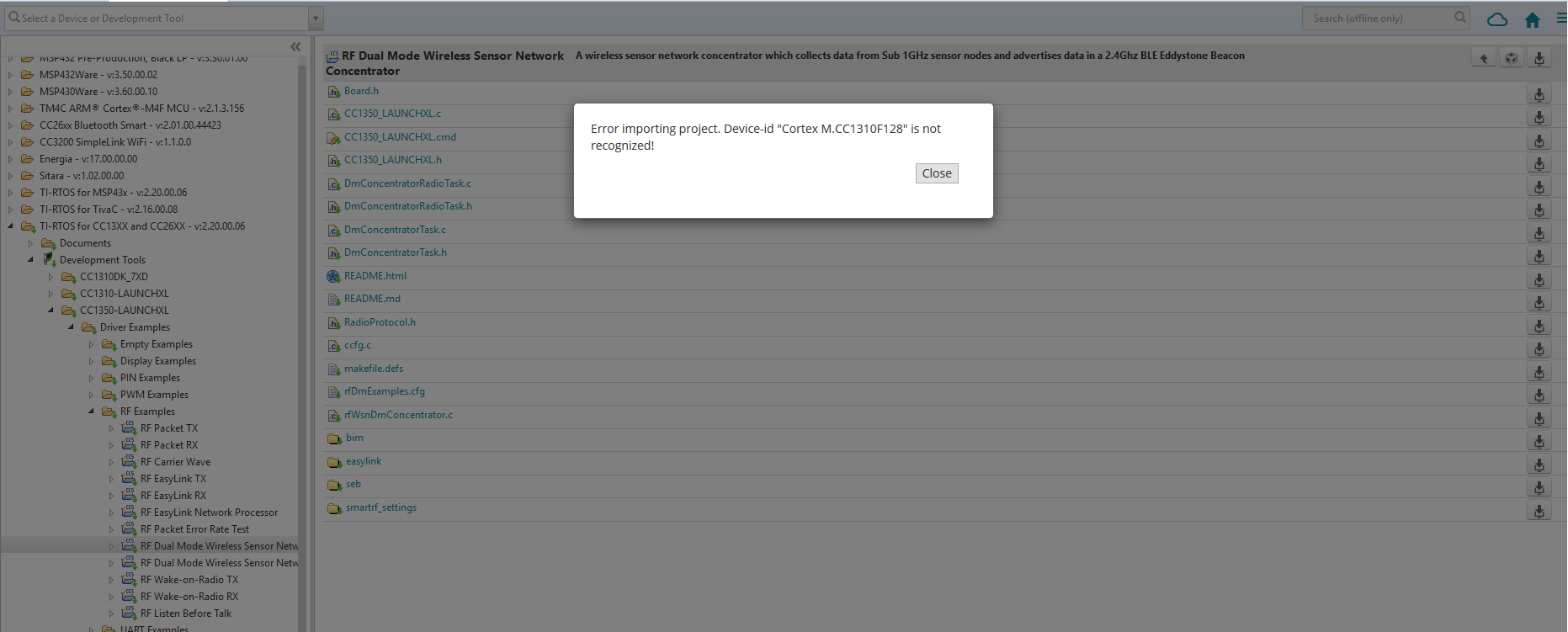

  • AartiG,
    Thank you for replying. I solved that problem through your suggestion but now i'm facing different error as shown in screen shot. Since i'm using CC1350 launchxl it's giving other devices error.
  • Please describe the exact steps/actions you are taking that lead you to this error message.
