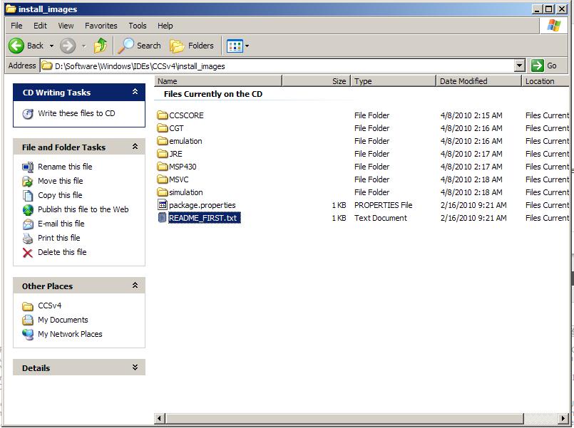

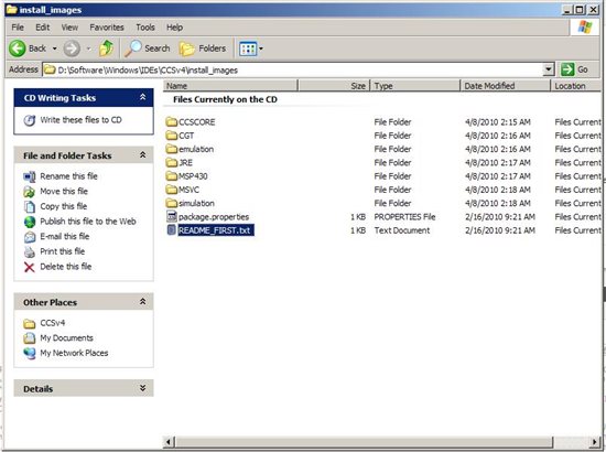

    In the folder that has the EXE, is there a subfolder called 'install_images' with content inside it?
  • I took a screenshot and a directory listing.  Here are both:

  • That looks ok.

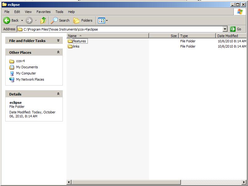

    After a successful installation, eclipse.exe should be located in <INSTALL DIR>\ccsv4\eclipse. Does that file exist? Also check the properties of your desktop shortcut and see if the path to eclipse.exe in the shortcut matches up
  • I would also suggest installing somewhere other than Program Files as you are running Windows Vista and Vista likes to lock down that directory pretty severely if you do not have full admin rights and UAC completely disabled.
    John
  • No, 'eclipse.exe' does not exist in that directory!  That would be a problem.
