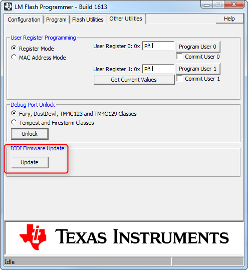

I have badly corrupted my TM4C1294 launchpad, so I needed uniflash to unlock the bootloader. Could not get it to work on linux nor on Windows VMs (XP and 10 tested), and uniflash even got the ICDI flash corrupted while trying to update it's firmware. Now it only shows as DFU bootloader, and uniflash won't restore it...

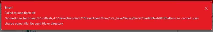

If I choose Firmware Update then I get missing library: libFlashDFUStellaris.so

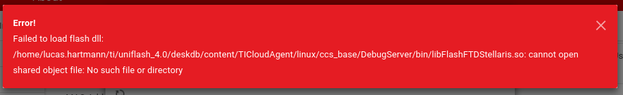

If I choose Unlock Bootloader then I get missing library: libFlashFTDStellaris.so
