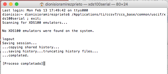

  • I'm still trying to make Code Composer to connect in my iMac 2013 with a CONCERTO.
    I've installed CCS 6.2 and 7 and I've updated both.
    I have used the executable xds100serial (common/uscif) and what I get is below.
    It strikes me that the serial number is empty and this is one of the possible reason given in the pup up error window.
    (I get the same problem when I try to connect a TivaTM4C129ENCPDT).
    Thank you
    See attached screenshots:

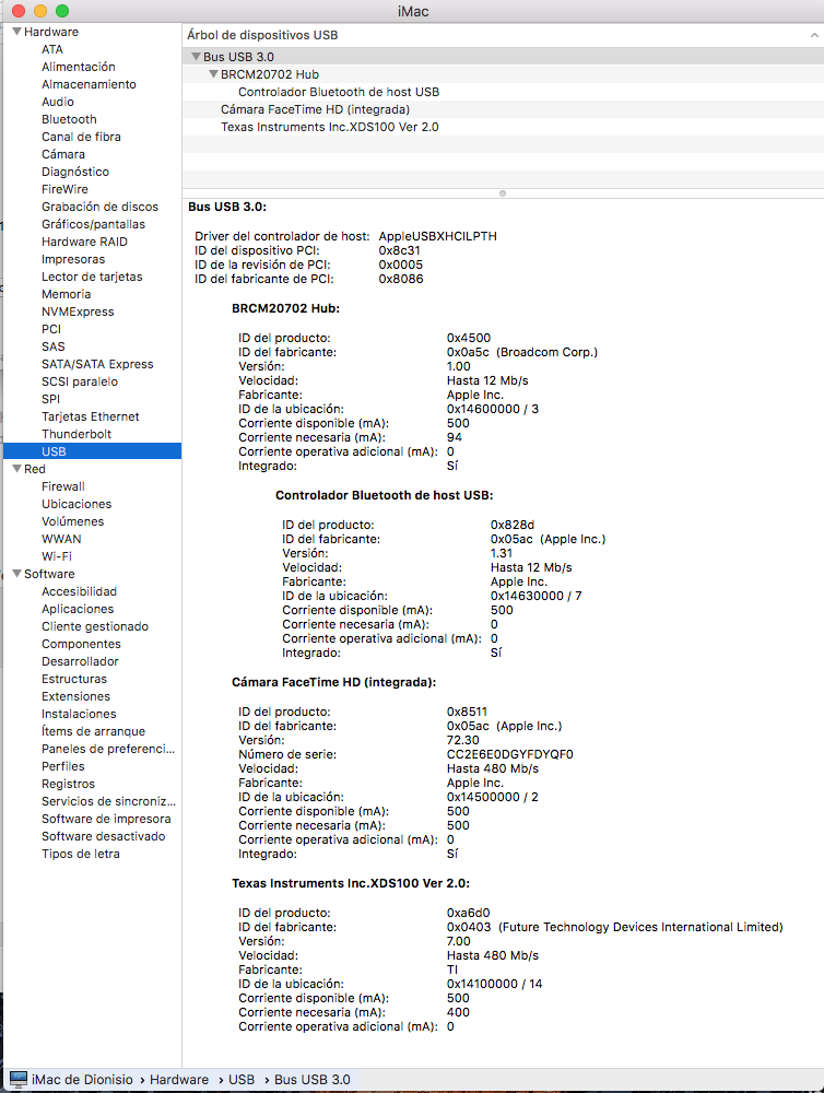

  • I've unistalled CCS and my virtual machine (Parallels) and I've re started the iMac.
    Next I've installed CSS v7 and I've updated it.
    However it is not working: it does not connect to the XDS100 because it does not find it.
    Nevertheless, it is detected by the Operating System when I connect the board (either the Concerto or the Tiva C) since I can see them in "About this Mac/Harware/USB: Bus USB3.0".
    Also, it detects the XDS100:
    Texas Instruments Inc.XDS100 Ver 2.0:
    ID del producto: 0xa6d0
    ID del fabricante: 0x0403 (Future Technology Devices International Limited)
    Versión: 7.00
    Velocidad: Hasta 480 Mb/s
    Fabricante: TI
    ID de la ubicación: 0x14100000 / 11
    Corriente disponible (mA): 500
    Corriente necesaria (mA): 400
    Corriente operativa adicional (mA): 0
    and the Stellaris:
    In-Circuit Debug Interface:
    ID del producto: 0x00fd
    ID del fabricante: 0x1cbe (Texas Instruments - Stellaris)
    Versión: 1.00
    Número de serie: 0F80056E
    Velocidad: Hasta 12 Mb/s
    Fabricante: Texas Instruments
    ID de la ubicación: 0x14300000 / 10
    Corriente necesaria (mA): 250
  • Now I've re installed Sierra but nothing has changed: Sierra knows that the XDS100 is connected (I can see it in "About this Mac/Harware/USB: Bus USB3.0") but when I push the "Debug" button in CCS v7, it does no find the XDS100.
    Now I have unistalled CCS and installed a fresh CCS copy and Parallels is still unistalled and finally I re-installed Sierra. Bu it doesn't work.
    Is perhaps an incompatibility of XDS100 with USB3.0 in MacOSX?

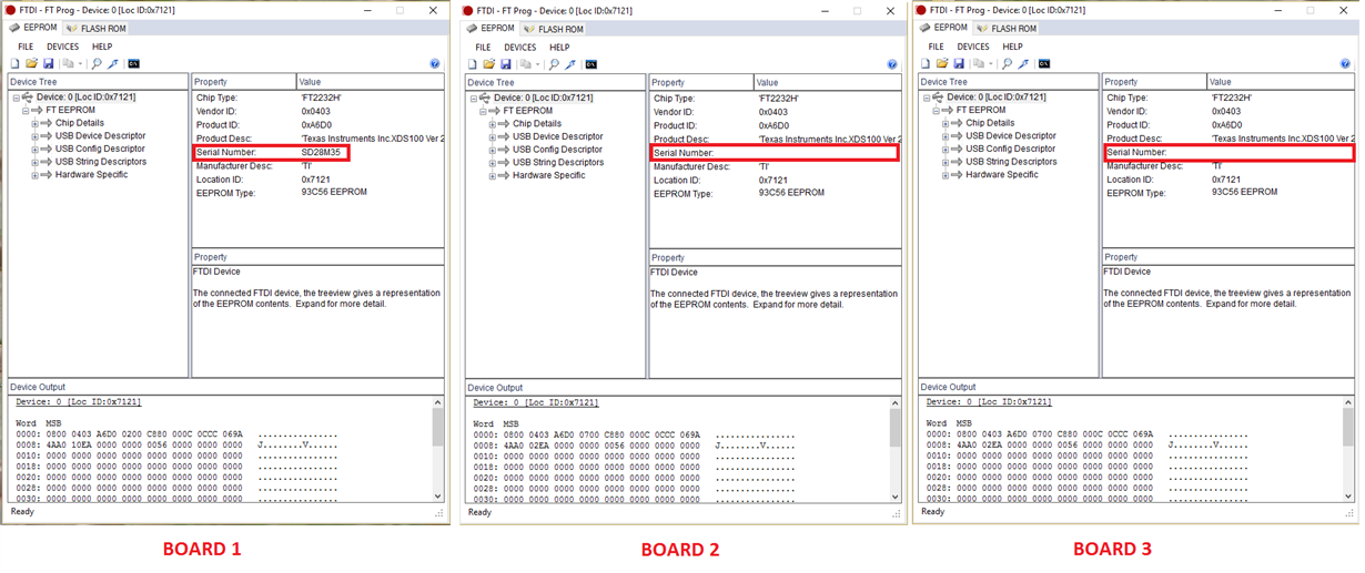

    I had a similar problem under Linux, also with a H52C1 Concerto controlCARD  - see CCS 6.1.2.00014 under Linux unable to connect to a XDS100v2 with a blank serial number
    In my case, using FT_prog under Windows to program the XDS100v2 with a auto-generated serial number starting with a "SD" prefix then allowed the XDS100v2 to be used under Linux.
    Maybe that will help in your case.

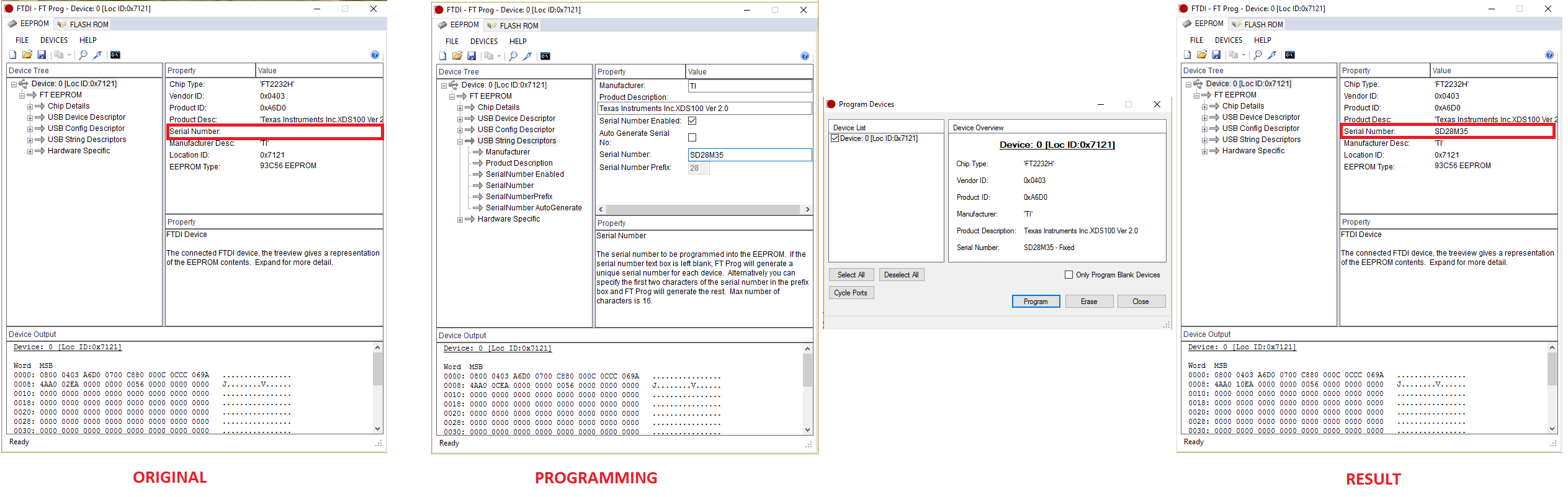

  • Hello Chester
    You are right: I've checked three different CONCERTO boards using FT_PROG (http://www.ftdichip.com/Support/Utilities.htm and one have serial number and two don't.
    I've programmed the serial number like the original: SD28M35:
    I've already checked them all in my iMac with CCS v7 and they all work now!!
    Thank you!
