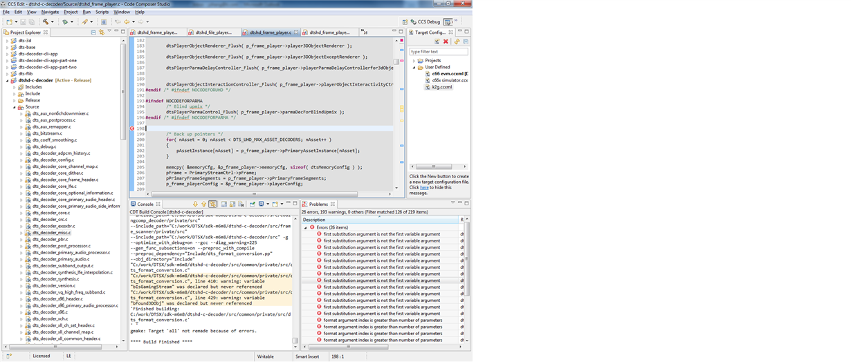

I got a few compiler errors with 8.1.2 CGT, while 7.4.4 CGT works fine. The error messages comes in pairs as following and happen at random places. I captured a place with empty line (picture attached). Thanks for your help.
first substitution argument is not the first variable argument
format argument index is greater  than number of parameters
  • I suspect all of these errors have a common cause.  I need to reproduce it to explain what happened.  Please preprocess one of the source files that have one of these diagnostics, and attach it to your next post.  Also show all the build options exactly as the compiler sees them.

  • Hi George,
    The errors are actually all in stdio.h line 198. I will send you a pre-processed file through email.
    Yimin
  • I can tell you what occurred.  But I don't know how it happened.
    The file stdio.h you have is corrupt.  The lines for the declaration of the functions sprintf and snprintf are messed up somehow.  Since I am looking at the post-processed form of the wrong code, I'm not sure how it looks in your copy of stdio.h.  But these are the correct lines ...

  • Look for any definitions of a macro named sprintf or snprintf in your source code. Remove them.
  • they are both used extensively in the code. Is this a known issue in CGT 8.x?
  • You can use sprintf and snprintf all you like, but you are not supposed to redefine them
