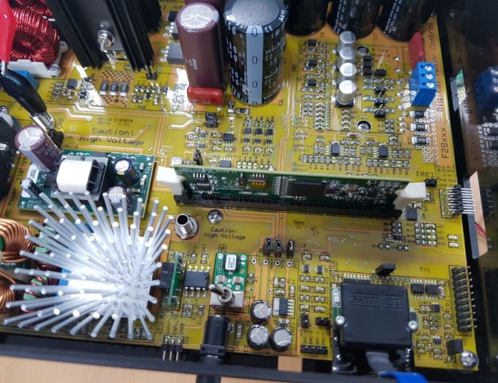

I have brand new TMDSHVMTRPFCKIT and problem to connect emulator(on board and external).
There's similar issues here so I reviewed all the answer but still couldn't find the solution.
Please help me.
I use SD XDS510USB plus and on-board XDS100v2 emulator to connect the F28335 control card.
Both are failed to connect target. Only [M3-J5] jumper setting is different between 2 emulator using.
here's my board pin setting.
- the SD XDS510USB and F28335 control card works fine. I've tested both with experimental kit(Docking-STN usb emu).

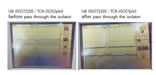

- When I test the on board emulator, I can read the FTDI device VID=0403 PID=A6D0.
But when I check the EMU TCK signal the signal doesn't seems to works properly.
Is it work normal?
So far I've tested this without MOTOR. Do I need to connect?
Jay.

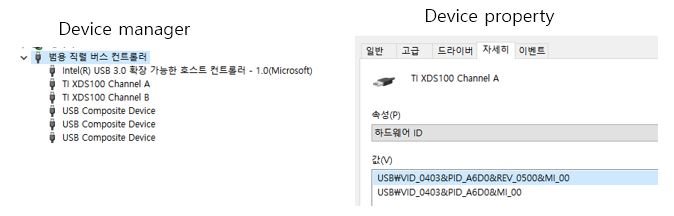

    If you want to use the on-board debugger, you'll need to remove the external one first of all. When you have the USB connected to the HVKIT debugger, can you find the XDS100 in your Windows device manager? That's the first step I'll need you to check if you want to go down the on-board debugger option
    Sean
  • Sean,
    Thank you for your support.
    I'm using windows10, and I think device manager recognize well.
    but unfortunately onboard xds100 seems don't operate. I couldn't find tck signal.

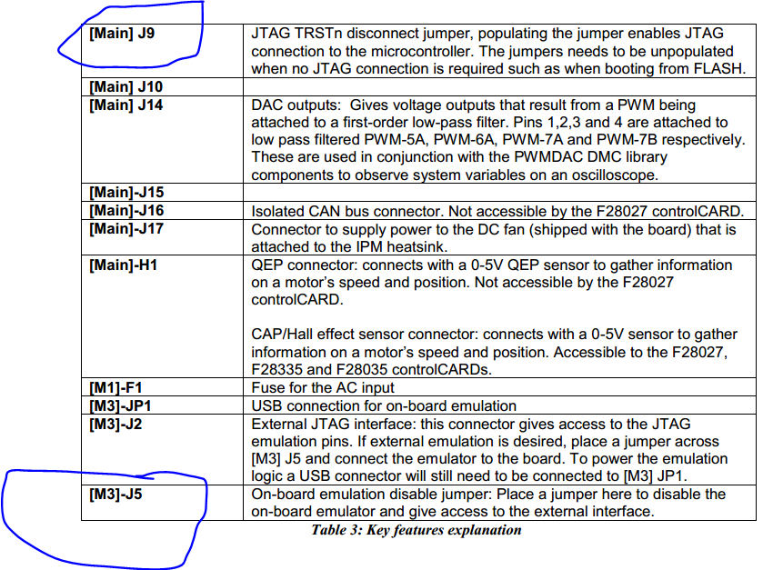

  • Hi Jay,
    Would you double check if J9 is properly connected? The emulator test result shows that there is some signal not connected properly to Mcu.

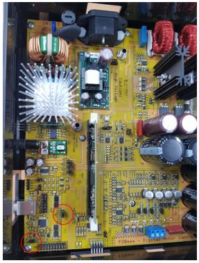

  • Hi Igor,
    I double checked the jumper setting and couldn't find mistake.
    now I am testing onboard emu - xds100 and this is my setting.
    [Main-J9] : connected
    [M3-J5]: disconnected
    Jay.
