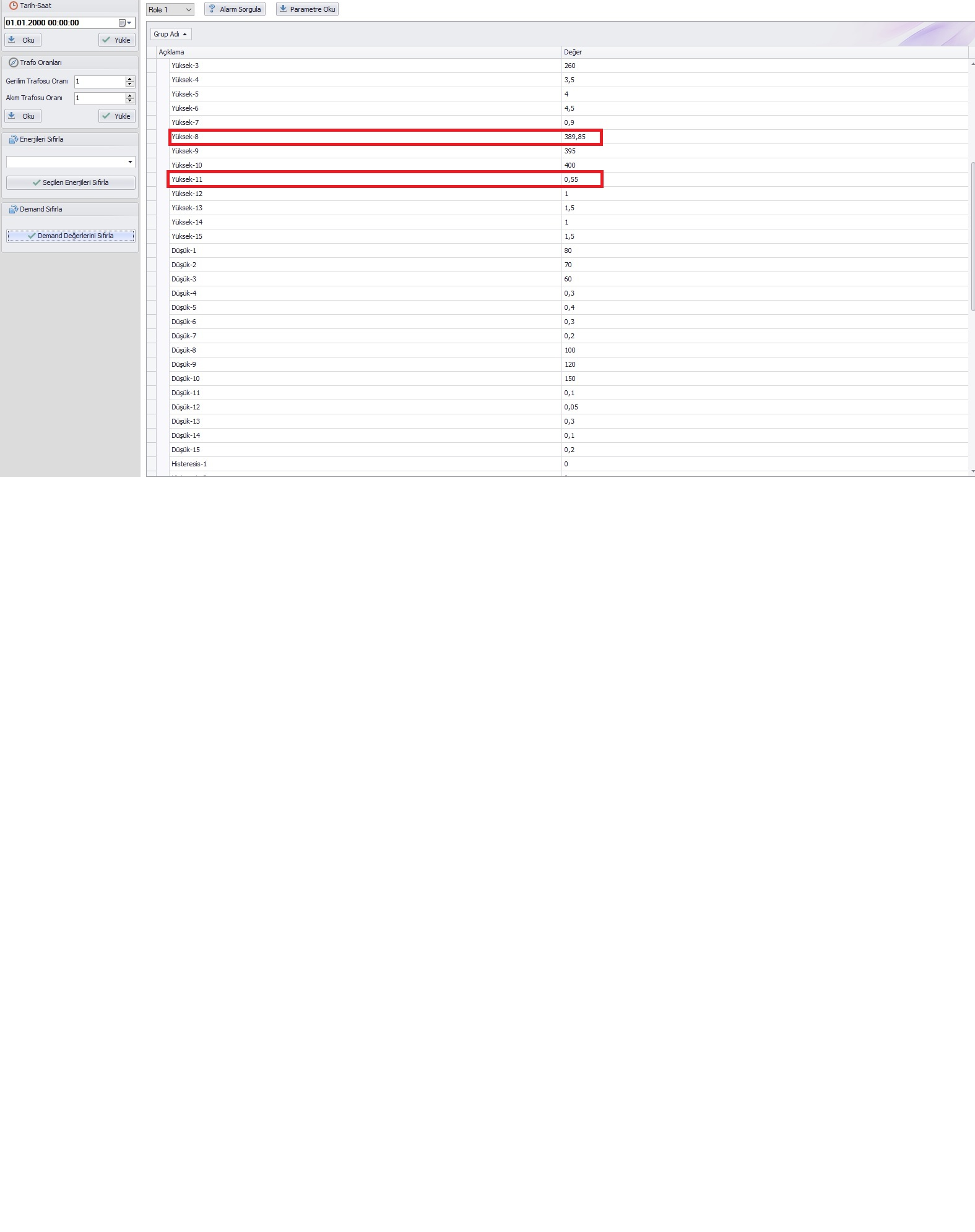

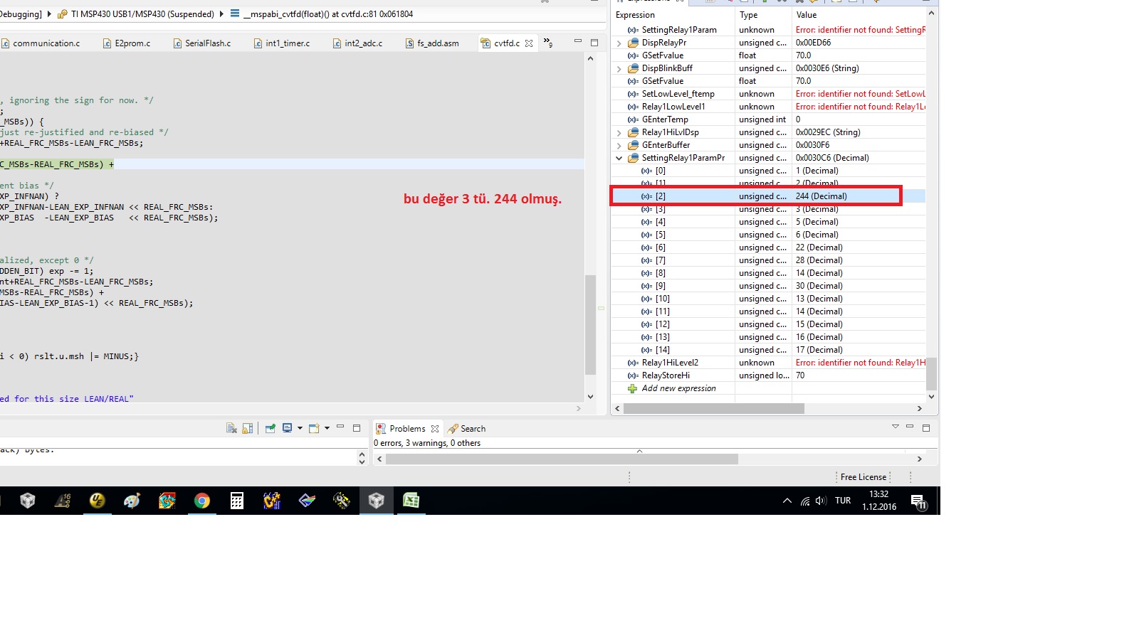

One of my customer is working on MSP430F67791A. They are facing the issue with the register content on CCS.  Please see attached the picure of this issue. They are entering the keypad value and store in EEPROM and then they read from EEPROM and load to one of the register of MSP430. They observed that the reqister content is changing randomly even if they dont change the keypad value and the content in EEPROM is correct.
Could you please comment on this issue?

    It is possible that CCS is reading the data incorrectly, but it is hard for me to comment for sure. Is the content ever displayed correctly by CCS? What happens when you view the memory directly via the Memory view?
    Yes, the content data looks correct at the beginning. But, this content data changes over time. This event is especially at float values.
    The content data is getting a diffrent value than it should be.
