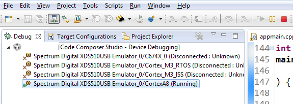

  • Hi Ki,
    Thanks for your reply.
    CCS version: 6.0.1.00040 (From Help->About)
    Device: DM814x SoC
    Breakpoints in RAM.
    Optimization is disabled. (Compiler Flags are -mv7A8 --abi=eabi -me -ms --gcc --preproc_with_compile --neon)

    • Launch Debug Session.
    • Connect to Cortex ARM A8 core.
    • Load the .out debug image for A8. After a while CCS could locate the main() automatically.
    • Set some breakpoints using address from map file and\or from line number column in source.
    • RUN A8.
    Expected: Breakpoints hit.
    Observed: Breakpoints never hit.

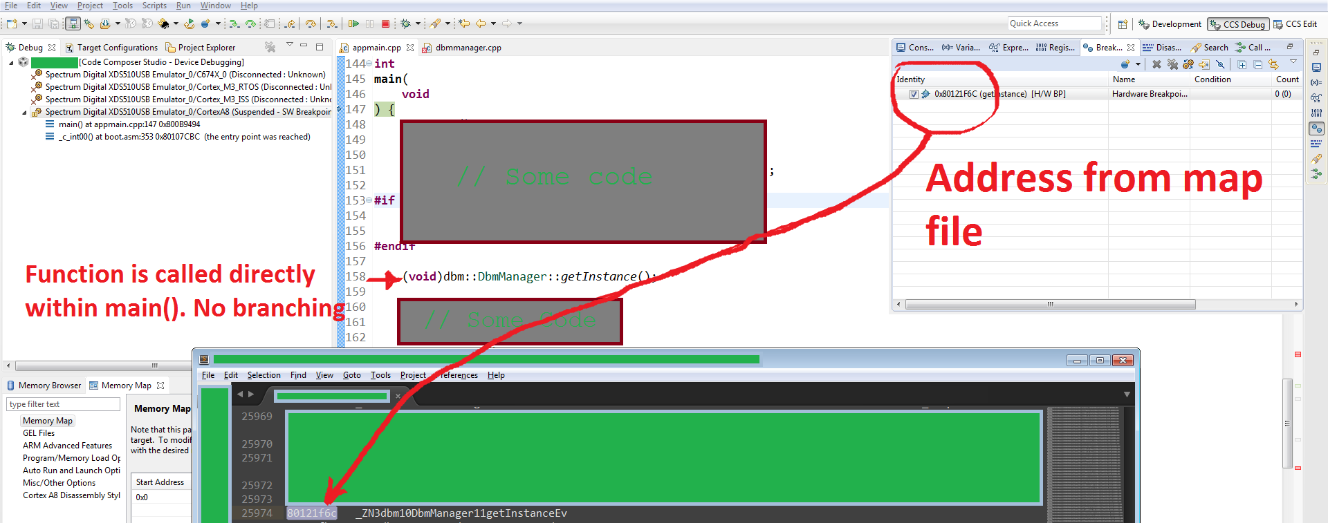

    Screenshots:
    After running, the breakpoint is not met.
    This is a multi-core SoC, where there is a synchronization between the 4 cores using TI IPC package. However, the breakpoint shown in the screenshot should be executed before coming to the point in which A8 waits the other cores (which I didn't load images for).
    I also tried to load the images for the entire chip, and got the same result.
    Please let me know if I can provide any further details.
    Thanks in advance
  • Sorry for the delayed response.
    Looking at your screenshot, it looks like a hardware breakpoint was set and enabled at 0x80121F6C. Can you confirm that the program does indeed reach this location? Can you single step to it?
    ki
  • Hi Ki,
    Thanks for your response.
    I could step over every and each line before line 158, and when reaching line 158, I could also step into the implementation of getInstance() method, then I could step over the few lines after line 158.

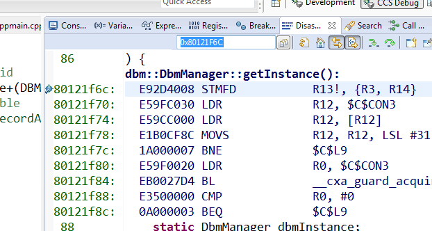

  • Can you also open the the disassembly view and show the breakpoint set at the specified address?

  • Hello Ki,
    Kindly find this screenshot, showing the breakpoint set in the assembly view.
    The used board is customer board.
