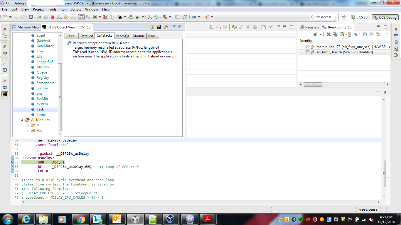

Working on TMS320F28335 custom board, an application which is running on TIRTOS platform.
Wanted to see the callstack, please let me know how to check this. Please find the screenshot attached
  • Ashok,
    If you are looking for a standard C callstack it will be shown in the Debug View. It looks like you have this view minimized as I see the icon for it on the vertical left hand toolbar. Click on the bug button on the left hand side of your CCS window. The debug view is one that you will want to keep open at all times while debugging in CCS.
    John
