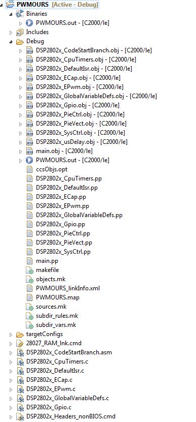

hello, I am new to microcontrollers.
I tried to execute epwm program using f28027.
I am getting no errors and warnings but no output.
when I compared with other PWM program, I found that a file namely "CPU Timer.out - [c2000/le]" is missing in Binaries folder under my program in workspace
Can you please help me how to tackle this type of issues?

  • this is how my workspace looks like
  •  this is how the workspace of the working program looks like
  • you can see the only difference is CPU Timer.out file
  • Madhuri,
    The Binaries folder in the Project Explorer view is a "virtual" folder that, by default, references the executable file(s) in your active build configuration sub-folder (ex, 'Debug'). Usually the name of the .out file is the same name as the project (but it can be customized, of course).
    From your screenshots, it seems that the 'PWM UP DOWN" project has a CPU Timer.out file in addition to the .out file generated by the project build. Perhaps this file was copied over into the "Debug" sub-folder or perhaps it just remained there from a previous build, but it should not impact execution of your project.

  • hello,
    actually, my code is not giving any errors. I tried all the ways I could. but still its not working. PWMUPDOWN was same code, it is executing properly and giving me output. the same code in PWM0URS is not working. I am not understanding why. the only difference I could find is CPU Timer.out file is not getting created.
    Is there any other ways to check why that particular file is not getting created during debug process. Please help me.
    The build of a project results in a single executable (.out) file. In the case of PWMOURS that would be PWMOURS.out (unless the output file name is specified to be something else).
    I don't know and cannot explain why CPU Timer.out is also there in the other project's \Debug directory and what its purpose is. You may want to check with the creators of that original project, but from a tools perspective, CCS will only generate one .out when building a project.
  • hello, I got the output by changing optimization settings.
    please can you help me find a pdf or any source to understand these optimization settings?
