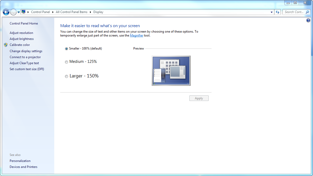

My new Dell XPS 15 Laptop has a 3840 x 2160 screen resolution; this caused issues of tiny icons in CCS 6 that were apparently going to be fixed in CCS 7 by the use of a more up to date version of Eclipse.  Now I see that CCS 7 is released, I tried to install but couldn't get bast the very beginning install screens as I can't see the check boxes and I can't make the dialog box bigger.  See picture.
Any ideas?

  • Here is what I want to respond with but I am having trouble so I will have to come back to it.
    To do this it is necessary to create something called a response file.  The response file contains all of your installation options and then you pass that file to the installer.
    To generate the file I ran the installer on my machine with these options ccs_setup_7.0.0.00042.exe --save-response-file C:\Temp\response.txt --skip-install true
    I had that last option to skip doing the actual install since I have CCS installed.  I have zipped the generated response file and attached it to this thread.
    Then to perform the actual install run the following
    ccs_setup_7.0.0.00042.exe --mode unattended --response-file c:\Temp\response.txt
    I have the installation directory set in the response file so you may want to edit that.  It is setup to install MSP430 and C2000.

  • I was able to get the response file method to work. My shell was just case sensitive.
    I ran cc_setup_7.0.0.00042.exe --mode unattended --response-file C:\Temp\response.txt

    We think the issue is related to auto-scaling of text.  If the response file doesn't work you could try adjusting the text display settings.
    John
  • Thank you John.
    I tried the tiny ant-sized font approach but all the windows scaled as well so I had the same problem but much smaller. After a couple of false starts with the unattended install method (before I realised that the command needs to start with ccs_setup) and another couple (before realising that the full path to the response file is compulsory even if it is in the same directory as the installer) it installed and runs. I do have an issue with the resource explorer window in that it seems to be a fixed proportion of the main window and it is cramped and unpleasant to use, see picture. Squishing the Project Explorer pane makes it usable (just).

  • I'm concluding that CCS doesn't install on systems with high DPI displays? The solution is to make that obvious to the CCS users.
  • You can install on a 4K display but it is not simple.  I have updated the CCS download page to highlight this.  The team is working to come up with a solution but I agree that for now we need to let people know before they install.
    John
  • The best way to solve it on Windows 10 is
    1. Disable scaling (set to 100%)
    2. Go to Display settings - at the bottom there is an "Advanced display settings" test line you can click on. Click on it!
    3. On most PC's you can there select a lower resolution. Select one that is a multiple of your current screen - or something like 1920x1080. Then the Display itself will scale without windows but it will look blurry while you do it.
    4. Log out and log in again to make certain all effects of scaling are done
    5. Install CCS
    6. Run CCS... Complete all updates etc and extra's installs.
    7. When CCS is setup completely - reverse the procedure
    8. So go into Display Settings/Advanced display settings - set resolution to "real " display resolution
    9. Go to scaling and reset your scaling settings.
    10. Log out - and login again to fully enable scaling.
