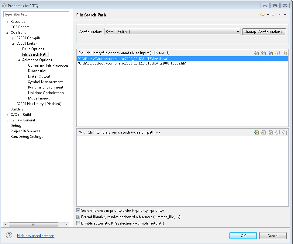

    In my cmf-files I have not specified a linker path;
    Only in the "properties" of the CCSv6 project: see attached file!
    The CMD-File I attached also, with the extension txt instead of cmd!

  • Ralf Koester said:
    I set the option --supress warnings, not to see this, and I do not no why,
    this morning I removed the option --supress warnings and the warnings disappered.
    I'm not quite sure what happened there, but good to know that the warning no longer appears. I will go ahead mark this thread as answered.
    Also, just FYI, in your Project Properties, you do not need to specify both libraries libc.a and rts2800_fpu32.lib (it doesn't hurt to have both but is not necessary).
    libc.a will automatically pull in the appropriate rts library based on the project compile options.
