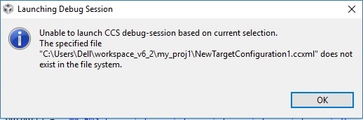

Can somebody help me with a error in the CCS:
This file is not part of my project.

Part Number: TMS320C6657

Sounds like there was a ccxml file that was part of your project but has since been removed, and you have no user defined ccxml file set to default. Try creating a new target configuration file for your target and place it inside your project.
